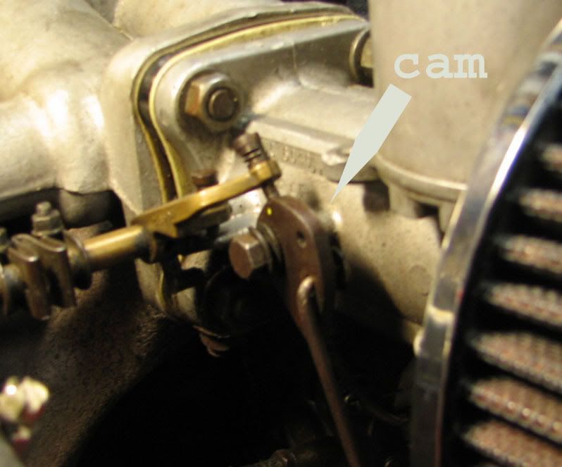

Hi Craig. Same thing happened to me. Took two feet against the dash and both hands on the knob to get the cable to pull. Here's what I did to fix it:
- checked to make sure I could lower the jets by hand without them binding (that determined the hang was the jets, and not in the cable or linkage). The jets were indeed very tight.
- removed and polished the jets (I used toothpaste, but don't tell anybody ...)
- put vaseline on the seals
- re-attached and re-adjusted the linkage, to make sure the first "inch" of cable pull only activated the cold idle cam and did *not* start to pull the jets down
Hope this helps. I'll scout out my original thread on this for you.
Tom
Instead of removing and polishing the jets, could you just drop the jets down and add a tiny bit of lithium grease? Isn’t part of the problem the routing of the cable sheath under the dash. Too many sharp turns?
