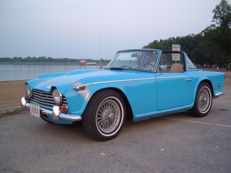

My spare set of "competition" springs are not on the car because of the ride height they gave. There was a huge gap from the bottom of the wheel arch to the top of the tire, especially with my 205/60-15. The car almost looked like a 4x4 conversion.
Mine were purchased in the early '90s from TRF.
I was real happy with these. They are 1" shorter but settle less thereby making the ride height just fine. You may consider the 1/2" spacers, but I didn't need them. https://goodparts.com/shop/index.php?productID=280
Here's a picture of the car with the springs and the new owner.

Yes, I did use the rubber packing. I didn't notice the gap as much when I had them on my old car.
I bought Richard Good's springs when I restored my current car and have been very happy with them.

glemon, I got Richard Goods springs for my TR250 and can't be happier. I use mine like yours for around town, fun drives and the occasional auto cross. Never thought they were too stiff for the road over 25k miles. Perfect ride height. Many of the heavy duty springs out there give too high of a ride height and looks terrible. I did use one 1/4" spacer on the front because I was uncomfortable with how close the front tire was to the fender. Experts thought it was ok but my concerns have vanished.
