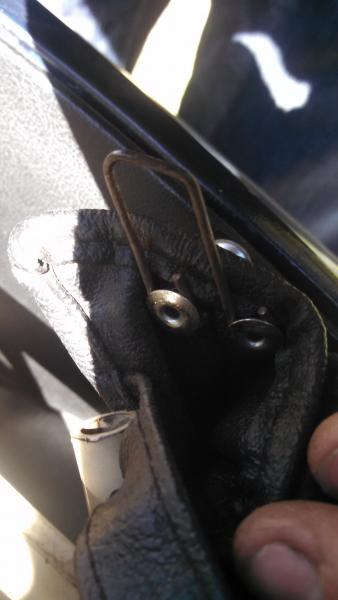

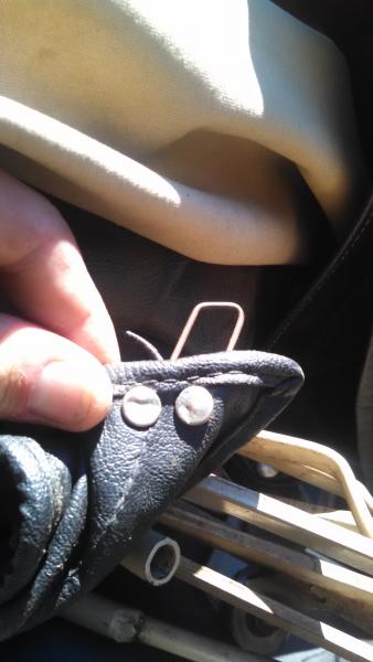

I know that on TR4 the clips (613767) are standard. I recently saw a TR4A that had these installed. My TR4A has the pieces on the windshield frame to accept the clip from the top but I need to know if I should have them or not. I would also like to confirm that what I saw is the proper design, Rimmer Bros sells a replacement but it only uses a single rivet as apposed to two rivets like is shown in the parts manual and the car I saw.

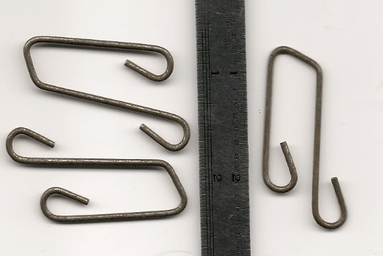

My 4A had them on the original top. Here's a shot of the clips that I've not installed on the replacement.
