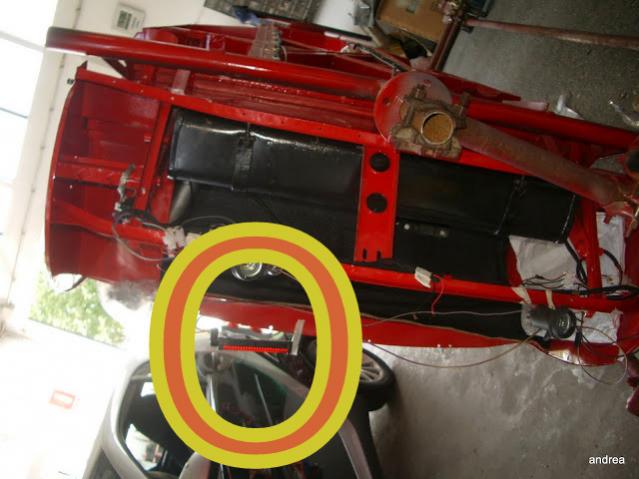

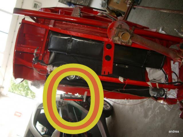

I have followed the suggestion of one AH UE customer on this list and have acquired on e bay for USD10+S&H (HogKong??) this
strip- photographed during the wiring tests of my frame
https://picasaweb.google.com/lh/photo/W3WBQLC6Q5ew8MBINCTQoA?feat=directlink
my intention is to place a steel strip under it, a felt protection under the strip, and a magnet on the boot (speaker magnet??
Andrea)
PS I have modified my wiring and have one wire dedicated to the brakes lights
