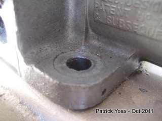

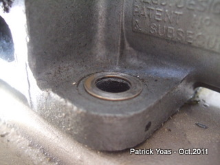

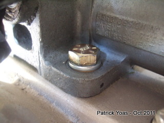

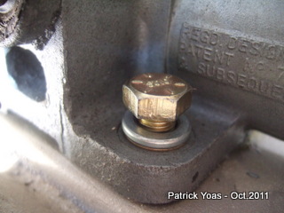

This is what I did to my Front & Rear Shocks to keep them tight and from loosening. It's called "spot facing".

Looks like a good idea (I prefer threadlocker to lockwasher on flatwasher, though). The rear shocks I've seen have something similar from the 'factory;' just the right size for a Grade 8 flatwasher.
