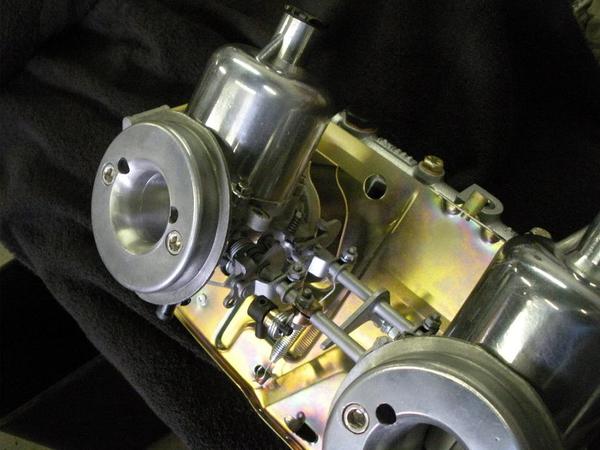

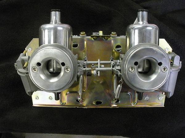

Here's a set of HS4s I recently rebuilt for a customer in the UK, with a few performance mods done to them, including solid mounting the stock velocity stack to carb for use with the K&N RU-4410 air filters. The performance mods included opening the ID of the stock aluminum velocity stack up to 1.5" and then port matching it to the carbs' throats, then thinning the throttle shafts as well.
