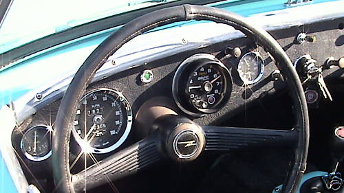

Tip: note the collar and horn trim are brown from age in one
pic.

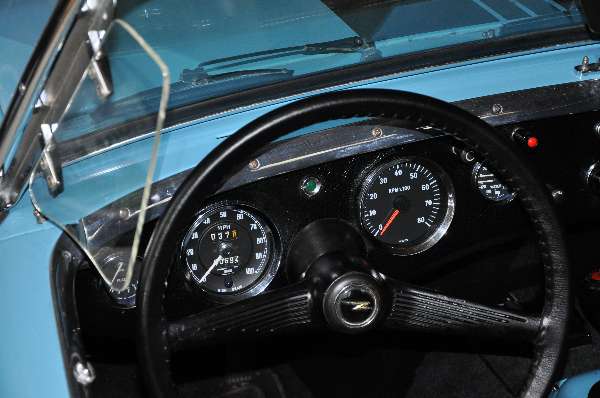

I used black shoe polish to get the things black in the second pic..
Made a BIG difference.
