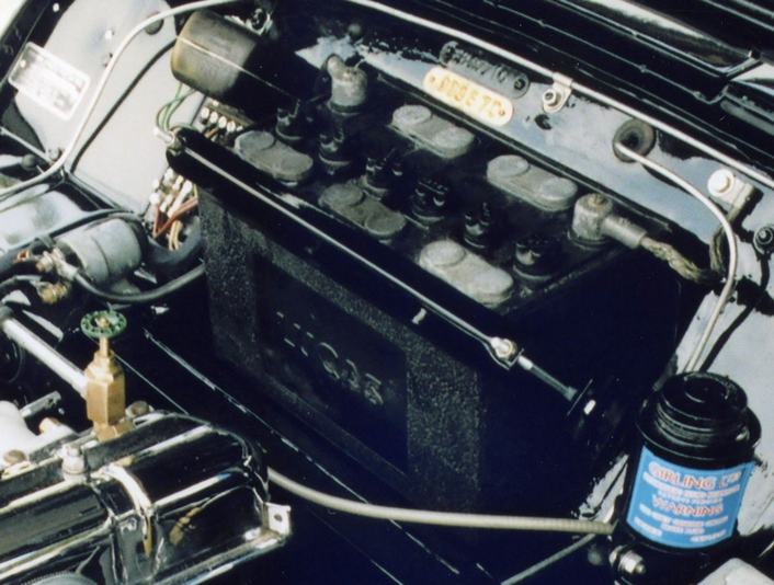

The battery in my 1958 TR3A is a Lucas replica I bought in Hudson Ohio in 2003. It reads 12.4 volts with the engine off and after a full winter in storage it will start my TR without even needing to be charged with my separate battery charger.
