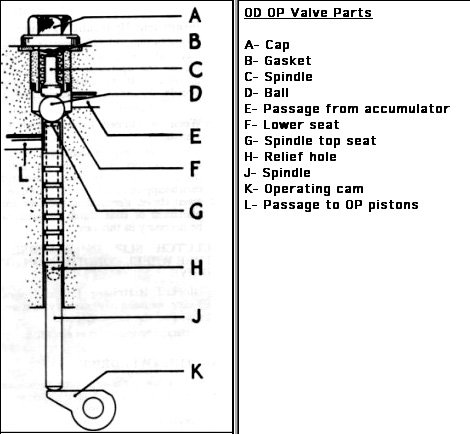

Assuming that the shift lever switch & the dash switch are working & that the solenoid is not actually operated when it should be off:
There are a few things you can check from the outside that would cause the OD to self engage or fail to disengage.
1- On the RH side near the front of the OD is a brass plug. Under this plug are a spring, a spring follower, a ball valve, & a operating valve spindle. There is a tiny hole in the side of the spindle that can become plugged. Clean this hole & the hollow center of the spindle.
2- The ball seals on the end of the spindle when the OD solenoid is operated & at the same time lifts from it's lower seat to allow fluid flow into the operating pistons. If the ball doesn't seal on it's lower seat the OD will not release. Check the ball seating on the spindle end & the lower seat. When the ball returns to it's seat oil pressure is cut off from the operating pistons & the pressure is relieved from the pistons via the tiny hole in the spindle.
3- The solenoid could be mis-adjusted to where it is not letting the spindle & ball drop far enough for the ball to seal on the lower seat when the solenoid releases.
Other --
The most likely internal problem would be that the OD release springs are too weak to disengage the OD.
The 5 speed would be a lot easier to do maintenance on.
D
Edit - Attached a pic of the operating valve.
D
It's a marvel to me that they even thought of a way to do this!
The OD seems to work fine most of the time. It will not engage or engage erractically after a long (hot) day of driving. It also does not stick on all the time.
The operating valve will be the first thing checked because all the other stuff appears to be working/adjusted correctly. Thanks for the diagram.

Hi Bob,
The OD sticking on when hot is likely caused by weak release springs inside. There are eight rather husky coil springs that shift the OD cone clutches from OD to direct drive when hydraulic pressure is removed. Commonly, when this happens, a rap on the brake ring, forward part of the OD case, with a lead hammer will release the "stuck" clutch. Trying to back up while in OD will also maybe release the stuck clutch but it's risky. If you force it too much, there will be broken parts.
Symptoms of a bad Sprague (unidirectional clutch) would likely be momentary over reving when shifting into OD or if bad enough, slipping in direct drive. Hopefully yours hasn't been damaged by forcing things in reverse.
Best of luck to you & keep the hammer handy, & do check the other items,
D
