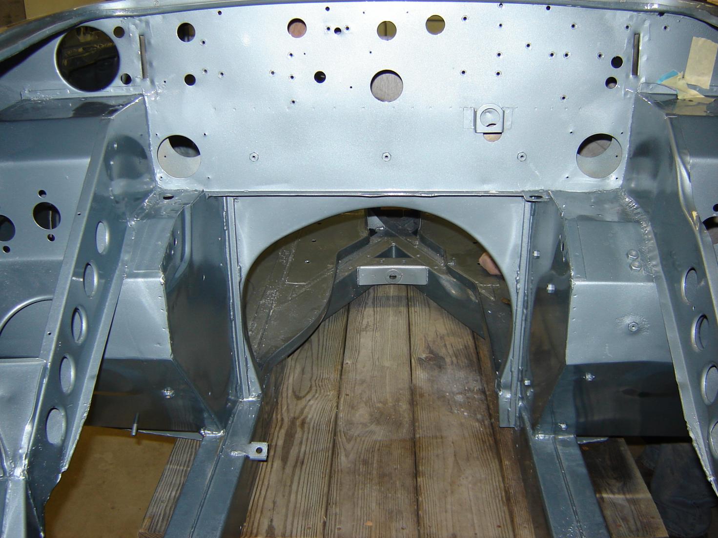

Steve, I read all the same articles you read about scuttle shake and how to prevent it during the resto of my '65 bj8 in 2007. It was quite confusing with some saying to weld in angle iron and some saying not to. I believe the story about the factory skimping on the welds at the factory and for that reason I had angle iron welded into the scuttle opening during the restoration process. Although I never drove my car prior to the restoration I do know that I have very little if any shaking at any speed except for those times when my tires are out of round or out of balance, when I have broken spokes, when I have mud and dirt on the wheels, etc. Yes I do get mud on my wheels since I do drive in all kinds of weather. I firmly believe that good wheel tuning is the key to a smooth ride as well as having the drums balanced and Hendrix Wire Wheel is who I recommend here. Maybe Bob Yule at Autofarm would have advice for the Canadian equivalent.
Anyway I have attached a picture of my scuttle after the scuttle stiffening angle iron has been performed and painted. My body man completely welded the sheet metal around the tunnel opening with a continuous bead and then welded in the angle iron using spot welds as seen on the picture. Just make sure the angle iron doesn't interfere with installing the tranny, clutch, etc. I'm not sure how easy it will be to do that with only the tranny out however. While you are there you should also install new bushes into the throttle cross shaft as well as your as pedal bushes. These are available from British Car Specialists and maybe other vendors as well. Good luck and have fun. George
Well, I'm trying to post a picture anyway. I'll post this and post the picture later.
George,
Thanks for the illustration. That made it clear. I wonder if it would make sense to add corner gussets or some sort of triangulation. After all, scuttle shake is a lateral motion, and I'd think gussets would add strength...?

Hugh,
The angle iron gives the lateral strength needed here I believe. Remember you first make a solid weld on all three sides of the scuttle sheet metal. Also there may not be enough room to add triangular bracing--it's a very tight squeeze getting the tranny back in. It may too close in there anyway with the engine in place.
