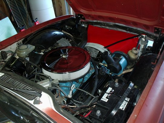

I picked up a early Chevy 350. IT had been sitting out front of my friends garage for sometime. A local machine shop did the crank regrind and cam bearing install. I put it together myself. Basically the SBC decision was one of parts availability. It turned out to be a bit heavier than I had planned - even with all the aluminum parts I could find. One thing is it does have one heck of alot of torque!
The wife and I cruised around the past weekend(I drove VERY conservatively). She really likes it. Highway stats are 2000rpm at 80 mph-effortlessly. It was alot of work to get there and a few $$. Lesson learned; I'd transplant a junked Camaro/Firebird rather than buying the parts here and there and putting it together. It would have cost me about half that way.
I've attached a pic from amonth ago.
