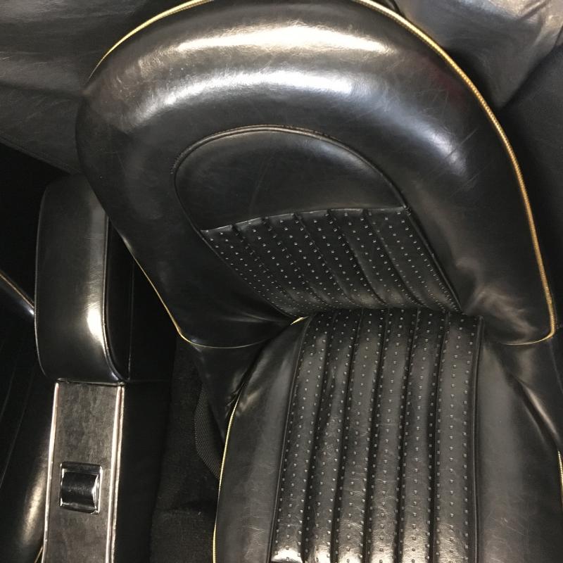

I am in process of recovering the seats on BT7. Have a question about seat bases. At the rear of the seat there are 5 square holes with sort of triangle on one side. What is the purpose of them? Is there a way to bend the point up and then press it through the seat cover from the bottom to secure it? If not how do you pull the center area tight enough to form the rear area? I have looked for youtubes, but have been unable to find any.

on my seats i left the points up. put glue on the base and the cover, then let dry. next i pulled the center tight and over the points. pushed the points thru the cover and bent them over towards the front of the seat. the glue and the points hold the cover.

Thanks Drone, The points do not look to have been ever used but it seemed that is what they should have been used for. The previous owner used double sided tape to hold the "flap"in place.
