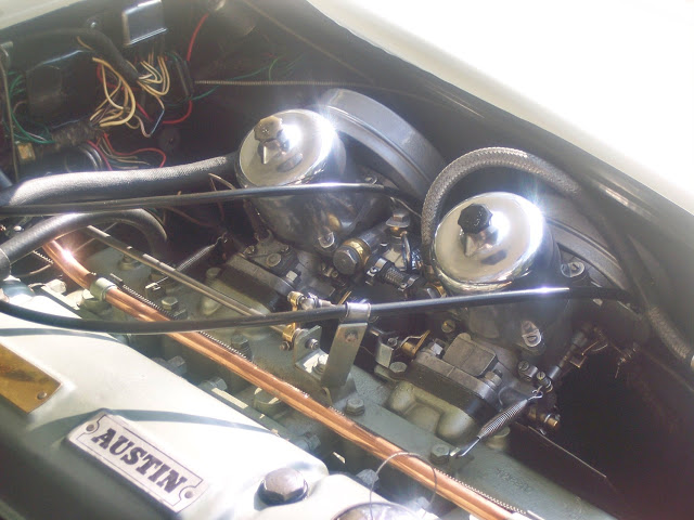

Your first decision is to decide what color you would like the body. As one with an original Old English White BJ8, I decided this was not the color I wanted for my engine compartment or wheel wells as, in my opinion, it provided a less then flattering contrast to the engine and got quite dirty quite fast. Since I had totally disassembled and stripped the car and wanted to keep my Healey reasonably accurate, I accepted the changed color of my total inner structure as the cost for my preference. As a result, everything under the outer OEW skin (floors, door internals and inside, engine compartment, wheel wells, etc.) was painted Ford Engine Compartment Black…a decision I have never regretted.
Healey engine green is an odd color to begin with. When placed next to OEW, it is not (in my opinion) presented well.
The last picture of the car provides a small indication of how the black tire blends into the black background and appears to fill the well. If OEW were used in the well, the area not covered by the tire would be accented to accent the tires smaller size when compared to the opening.
