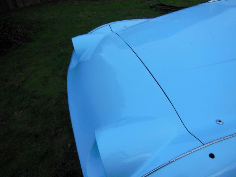

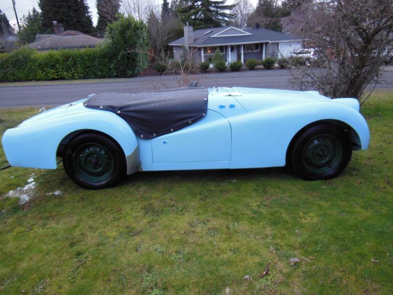

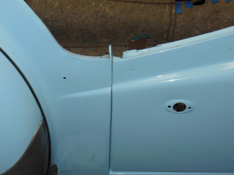

Steve, in the pictures it’s looking great! That bonnet to apron line looks perfect.
