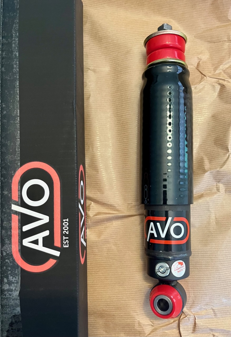

Done!
New AVO shocks ordered this morning.
I don’t have the model number but they are twin tube and adjustable on the car, and come with polyurethane bushings.
305mm - 210mm
Arrived today:
