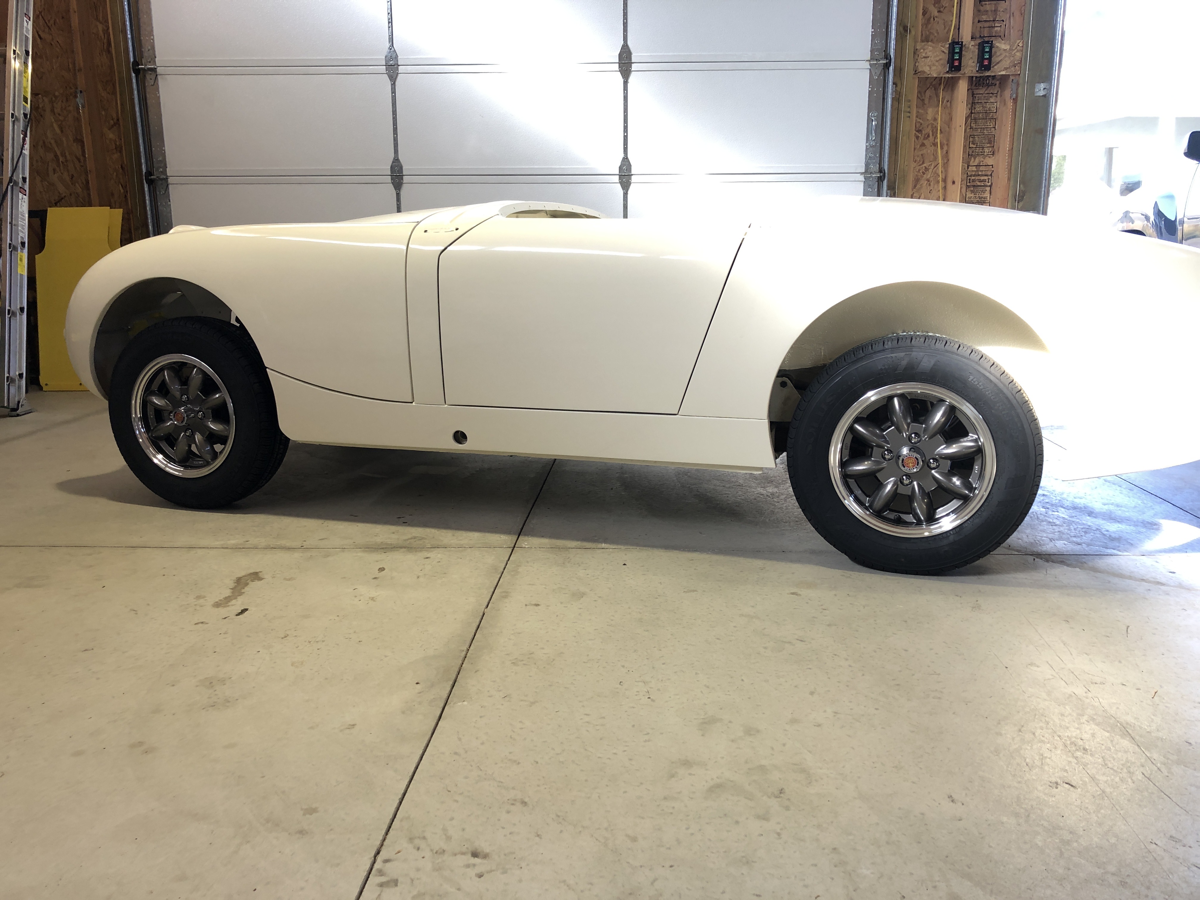

I probably should have started with other parts, but I just couldn't resist. Got 4 new dark grey minilites from Moss and had some new 155/80/13's put on. My flimsy justification is that I want the final wheels and tires as I redo the suspension and convert over to front disk brakes -- to make sure everything fits you see. Yeah, that's it... 😁
Saw these on another Bugeye at a local show this summer and it finalized my decision. They really are helping to get me motivated to start the reassembly and rebuilding work. Took a few minutes today to reinstall the VIN plate in the engine bay and the number plates in each A-pillar. Small things, but still necessary.
Once the Morris is back together and off the lift I'll pull the rear axle and get to work.

Paying someone to do the bodywork wasn't cheap, but I have to say that they did an excellent job. The car wasn't too bad, but there was rust to contend with.
Now I'm just paranoid that I'll scratch it while I'm putting it all back together. :eek::smile:
(maybe more along the lines of I'm just really careful)

It was a case of 50 year old wheels that have seen their share of hard hits. My car began its life in Chicago, Illinois and I imagine it ate more than a few potholes there. The only time it becomes an issue is when the flat spot on two of the wheels are synchronized with each other. It manifests itself with the steering wheel jiggling. It's manageable, but annoying.
If you have a SWA Sprite you are limited in the rear how big you can go 155/80/13 is about it. Fenderwells get in the way.
Drew, Were you able to get those wheels to fit, they look great BTW, without adding Spacers. My JBW Wheels, the ones that MOSS Sells, needed 1/4" Spacer in the back and 1/8" Spacer in the front to clear the Tie Rod End. Not sure of the offset in my wheels but I did need to change to longer wheels studs purchased from Winners Circle. In the rear I only had 3-4 threads available to tighten and that is not enough thread to ensure you aren't going to lose a wheel/Break a wheel stud.

The wheels are from Moss (Minator), and seem to fit perfectly fine with no spacers. When I change over to discs in the front I may have to file down the tie rod ends a bit for clearance, but don't expect that will be too difficult. Currently still on front drums. Running 155/80/13 tires.
I will be changing the rear backing plates to the later ones as well, so we'll see what's needed if that shifts anything, but I don't expect it will.
