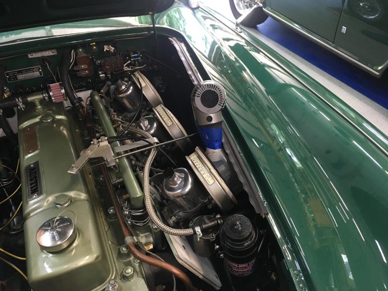

Has anyone modified a Unisyn or similiar device to fit over the top of a stock air cleaner? Since we all have multiple air cleaners that are a PITA to remove, this could save some skinned knuckles.

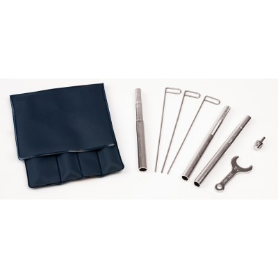

The Uni-syn's sole purpose is to balance the air flow between multiple carburetors; the simple SU tools you stick in the top of the dashpots can do the same thing, and more!

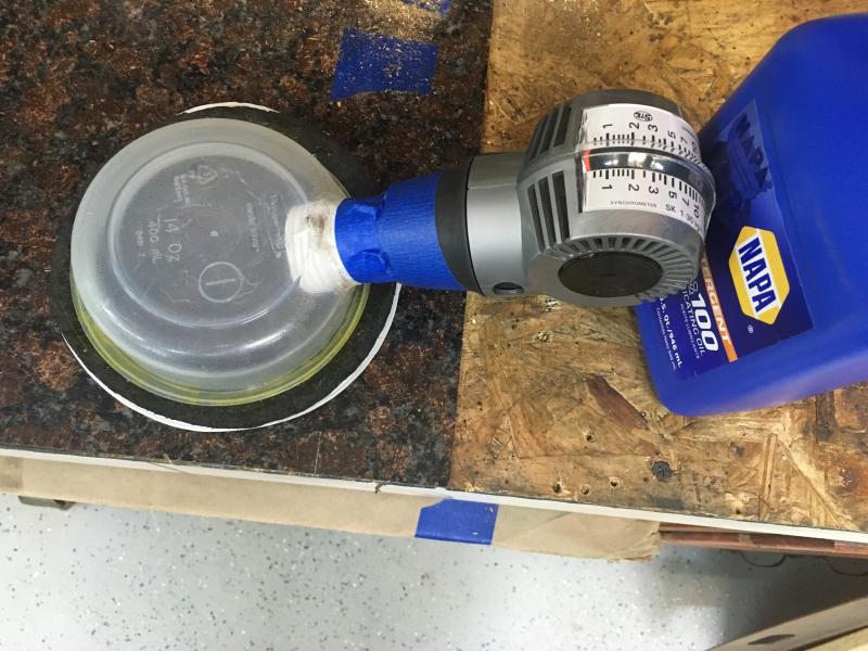

this is working pretty well for me.
tupperware bowl and hose for a sump pump. sealed in with lexel caulk. some cork glued to the bowl and then a little bit of self-stick rubber weatherstrip to seal the edge. just press it up tight. not pretty but it works.

The tools mentioned by Randy are just about the only way to use the piston lifting method to set mixture with any accuracy, as you can eyeball 1/32" pretty closely (I think the wire is about 1/32").
Edit: price may have since gone up...
Randy do you know if and where this tool is still available
Thanks for those great responses.
I'll order an SU Tool Kit and learn to use it.

tks Randy . I looked at all the listed tools on Moss site and I didnt see it .
Guess I may give it a try instead of my tube in the ear trick .
Just like there are different size screwdrivers, there are multiple choices (many MORE choices) for any given task. This simple and inexpensive set is what I started with forty-five (45) years ago, and what I'll use on the next set of SUs I set up.
On a different car with unlimited access at the mouth of the carbs, I might grab a UniSyn, but I wouldn't be able to tune it any better than I could with the tubes and wires. Just a different feeling handle ;)
