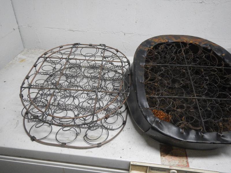

I head on over in time to catch the mailman and he has yet another package from TRF for my dad, and it's a new ignition switch (another story, another time) to go with the key-matched set I got him for Christmas. The one that was on his car was some JC Whitney special he installed way back when and actually forgot he did it. So we're sitting there chatting and I'm drooling over his interior kit (mine is black, but his is the most awesome biscuit tan (a bit darker and redder than you normally see) and I see my seats sitting there on the shelf untouched so far and I get a wild hair to really go through them. There is some rattling inside and I pull the lower cushion up to find the rails and bolts loose (PO must have stored them in there) and the pans are a bit dusty and there's some rusty dust. I wipe it up a bit and there's black paint showing through, hmmm. The bolt holes are nearly pristine, and except for the paint being a bit dull, the pans look pretty good, on both sides (in and out). I expected a lot more rust based on the amount of rust dust that was laying in the bottom of the pan. The seat bottom has horsehair showing through, so I turn it over and low and behold, my springs are barely recognizable as springs. Crap. I pull the other bottom out and not nearly as much dust. The fabric is worn and split but I can't see horsehair easily. Those springs are pretty oxidized but very nearly savable. I notice the bottom cushions very much resemble each other in shape, but the stitching pattern is different, and to make me even more confused, both seats fold.
Ok, so somewhere in the past 59 years, someone played musical chairs with seats. I am very nearly certain that they are TR seats as the pans and backs look exactly like my dad's and every other seat I have seen on the internet (including Jon's recovering thread). Two seats that fold might be pretty cool, but those springs.....
Besides restoring seats back to original, what other options do I have for rebuilding seats. I have the recover kit (still in package) and two pretty good pans and backs (though one seems to also fold backward but I haven't really gotten the seats torn completely down yet). Are the springs replaceable with some form of modern foam or system that I could build myself? Inquiring minds want to know

The Roadster Factory invested in a better set of seat springs, and if you use new springs you should definitely check those out.
Dan
I got my seat springs from Jonathan Skinner.
They are excellent. Looked almost exactly the same as the original ones I had.
David

John Skinner doesn't post prices, they quote on request. I had a quote last fall of ÂŁ82.96 each, which is $106.18 at today's exchange rate (1.28). This was for the earlier seat springs (TR2-3, pre-TS20014).
Now that is worth tracking down Keith. Do you happen to remember what shipping would have been? I'm not entirely sure that I need two, but at that price I might just jump.

Skinner got back to me as well, and get the idea that you can only buy a pair from him. If I want stock, he's the way to go. 77 pounds British per unit, 215 total with shipping.

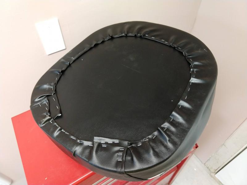

Get, the foam, a piece of plywood, adhesive and staples. I covered the foam with some angel hair gauze from the fabric store to keep it from being abraded by the cover.
This view from the bottom shows you how to fold and staple the cover. Easy peasy.
