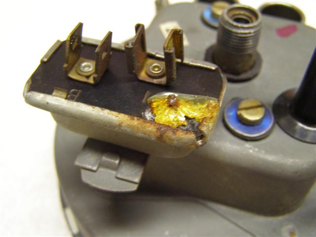

Check out the voltage stabilizer on the back of my original speedometer That little dude sprang a leak. Oddly enough, all of my gauges worked fine.

Mine looked that way, too, and all gauges worked.... can't seem to find it to take a pic...
That's the goo that Smiths used to secure the adjusting screw when they calibrated it for 10V at the factory. It's kind of like Duco-Cement. Later models didn't have an outside adjustment and won't have that "spot" on the back.
If the goo is still there and the stabilizer still works, by all means continue to use it. That spot's not a sign of failure.
