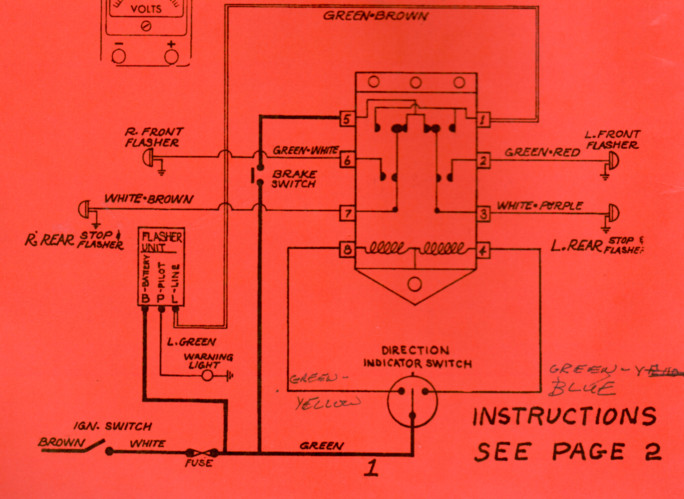

Jon covered it very well. The brake light switch ground is actually provided by the rear light bulbs. With the brake pedal depressed, you should have battery voltage at both posts of the switch, at terminals 3, 5 and 7 of the DB10 and the rear bulb sockets.
This image is from Norman Nock's Austin-Healey Tech Talk book - inside front cover. Available from British Car Specialists.

Since the direction and parking lights work, you have eliminated most of the troublesome bits. Either you are not getting power to the brake switch, the brake switch is bad (too common), or the wiring from the brake switch to the #5 terminal on the relay box is bad.
I checked the power to switch none there. There was a jumper from the old switch to the 35 fuse. I had forgot about it 2 years later . Looking at some of the zillion photos I took i remembered it when I reset the jumper the brake lights work. There must be an issue with the # 17 wire as shown on the electrical diagram. Probably the union connector. I think I’ll formalize that jumper I really don’t like poking around on the 70 year old wiring.
One item that always seems to trouble old vehicles is their ground connections. Looking at the Nock diagram listed by Bob, the case of the relay box provides the ground path for the relays inside. Also poor grounds in the actual bulb sockets. Just a thought.
