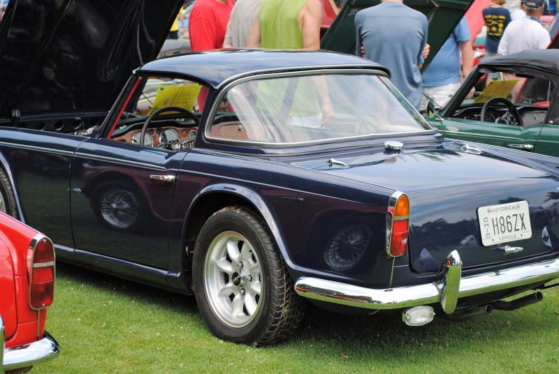

Here is a photo of my backup light installed on my 4A. It's the 494 example shown above. I made a small bracket that attaches to a bumper bolt. My 4A @ PVGP 2011.jpg
Looks nice Jerry, I did one on each side for a friend, very effective.
Wayne
Jerry, thank you for the photograph of your installation, which I will probably copy.
Gerald, (I'm another Gerald) if I recall I actually drilled a hole in the bumper bracket to mount the light. The car is in storage now but I can take a photo once I revive it for spring driving. I also drilled and tapped the transmission top cover for an isolation switch so the light turns on when I shift into reverse. That takes a bit of work but if you now have access to the transmission top cover I'd recommend doing the same. Lets take this to regular e-mail. My e-mail is jerryvv @ roadrunner dot com
