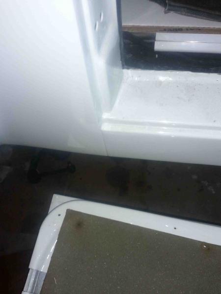

Just to save a few bucks for now I'm recovering my original interior panels. Viewing many options out there I've noticed that after TS60000 that the door edges are rounded and the available panels are rounded to match. If I round mine am I going to see the white paint inside the door jam because I'm putting a round edge into a square hole? Hope this makes since!

These are the panels I got when I originally restored the car in the late 70s. (They may not have been correct) The driver door panel is a little beat up on the corner and that is getting a new board. My concern is that there is going to be a gap in the corner now that it is rounded and will I see the white paint in the door jams. I'm asking first before I remove any material and don't want any surprises.
Not sure if I'm helping. Your photo shows a door with the rounded corners and appears to show a square corner trim panel laying on it. With the rounded door the trim panel should match the rounded corner of the door. I see the screw holes in the door frame, in your photo. Those screws would be only slightly inside the edge of the finished trim panel and the trim panel should lay just at the edge of the inside surface of the door and match the contour. With trim installed on the door, you would see almost none of the inside painted surface of the door. With the door closed, you would be able to very slightly see the hinge pillar at the front of the door, because the door opening is square and the door is rounded, which creates a small "triangle", but it's not large enough to really matter and is the way it was made originally. A square trim panel would fill the gap but would hang over the rounded edge of the door. Tried to get you a photo but couldn't get it to download from my camera. Hopefully the explanation helps.

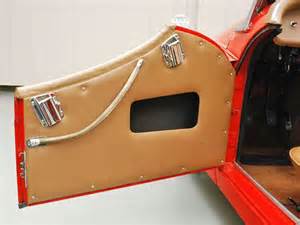

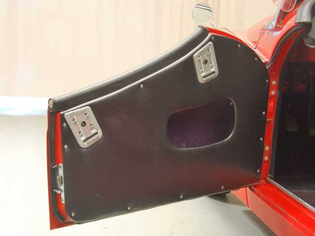

square door.jpground door.jpgtan is square...black is rounded. I found photos on line. Looking at the bottom edge of the trim panel. Also not the different shapes of the opening in the center. Later is kidney shaped.
Ok the pics helped. Mine is like the red one. I'll round off the corners on my panels to match the radius of the door.
