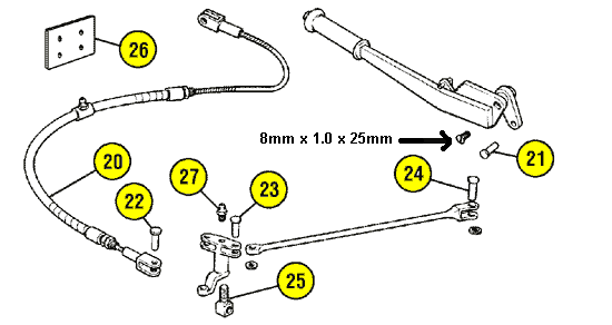

I need to replace the screws that mount the handbrake assembly to the body mount (see pic). The screw is a countersunk phillips head machine screw, 8MM x 1.0 x 25mm (fine thread 8mm, 1" long). NOBODY seems to have these. Not British Tools and Fasteners or Bolt Depot. Certainly no one locally here in Las Vegas. Does anyone know where I may get these or what may be able to be substituted. I know a 5/16 SAE, fine thread is close, but really not a perfect match. I'm at a real loss... /ubbthreads/images/graemlins/confused.gif

Only suggestion that comes to mind is Wurth fasteners. But they usually don't sell -one- of anything. Is there a shop in your area that services Euro cars? Check with them... Ooohh!! There's the "museum" near you. They *restore* cars. Go chat up somebody there!
I had to replace those too, and they are a pain to locate. I wasn't going for originality and used a countersunk fine thread machine screw from Home Depot. Since the head wasn't completely flat but slightly rounded I had to use a Dremel to flatten the top so it would clear the handbrake lever. The screwdriver still fits though, so no biggie.
The bolts holding the bracket onto the body were a pain too; a couple of the captive nuts on the inside of the tunnel had snapped off, so it took some patience with a hacksaw blade to remove those. I just used regular nuts with the breaker bar shoved in from the front to hold them.

yea, I don't see that spec being very likely. Are you sure it's metric? 5/16" fine thread seems much more likely....
Do you have a 5/16" tap? You could certainly make it 5/16" fine thread very easily /ubbthreads/images/graemlins/laugh.gif
Come to think of it, didn't the countersunk screws have separate nuts, and not captive ones? I seem to remember just getting nuts that matched the screws I bought (5/16" fine thread). Yes, someday I may be referred to as the DPO because I have a mixture of bolts and screws with threads that are different from what BL used. :p Usually I was more concerned with keeping things attached than originality, and it has had its share of captive nuts snapping off or bolts shearing off.

BTW, most everything on your car should be SAE. Does the 5/16 24 seem loose or tight? It may just be an issue of worn or rusty threads.

Thanks everyone for replying. Yes, all nuts are captive on the handbrake assembly. I haven't tried the 5/16 x 24 machine screw. I just used a thread pitch gauge to determine what type of threads they are. The SAE didn't seem to be exact, where the 1.00 MM pitch gauge seemed to be right on. Maybe I read it wrong. Anyway, I've looked at Lowes, Home Depot and the local true value (who has a great selection of weird nuts, bolts, etc). All have the 8MM x 1.25 (course thread metric), but not the 1.00 (fine thread metric). So maybe there's no choice but to try the 5/16 x 24.
I didn't give a 5/16 x 24 machine screw a try because I didn't think it was correct. But if others have used it, then sounds like that's my ticket. I'm not restoring to total stock, so being the "original" machine screw is not important to me. I was more worried about the screw backing out if I used SAE instead of Metric.

Early in my days of Midgeteering (aka about a year ago), I mistook quite a few 5/16 24's for M 8 X 1.0. At that time I assumed that becuase my car was Euro it was metric. Oops!
Consequently, if I ever sell my car to one of you guys, you are going to need a few metric tools...
An M8x 1.0 has 25.4 threads to the inch, and is commonly mistaken for a 5/16 x 24, by people who think that since it's a European car, it has to be metric.
