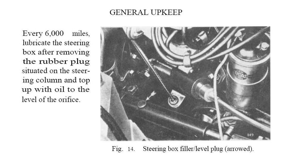

Is the correct level supposed to be at the fill plug?.....not that the oil will actually stay in or anything.:smile-new:
Yup.

Since I had my TR3 I have not removed the rubber seal in the steering column. I did remove the plug on top of the steering box and there was pretty yuking looking oil in it. I know I need to do something with it, but have not gotten around to it. So today, based on this forum thread, I decided I should at least pull the rubber plug. UGH, it looks like someone filled it with thick wheel bearing grease. Questions:
1)Any idea how I can get that grease out?
2) What's a good way to drain the steering gear box without removing it from the car and also without removing the front cowl?
3) And should I buy the special "Penrite" oil that Moss sells for steering boxes, or is there some other oil that is just as good?
