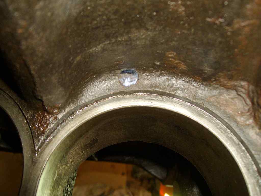

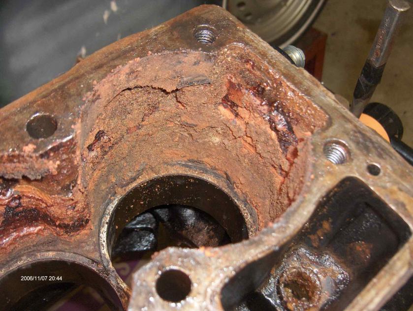

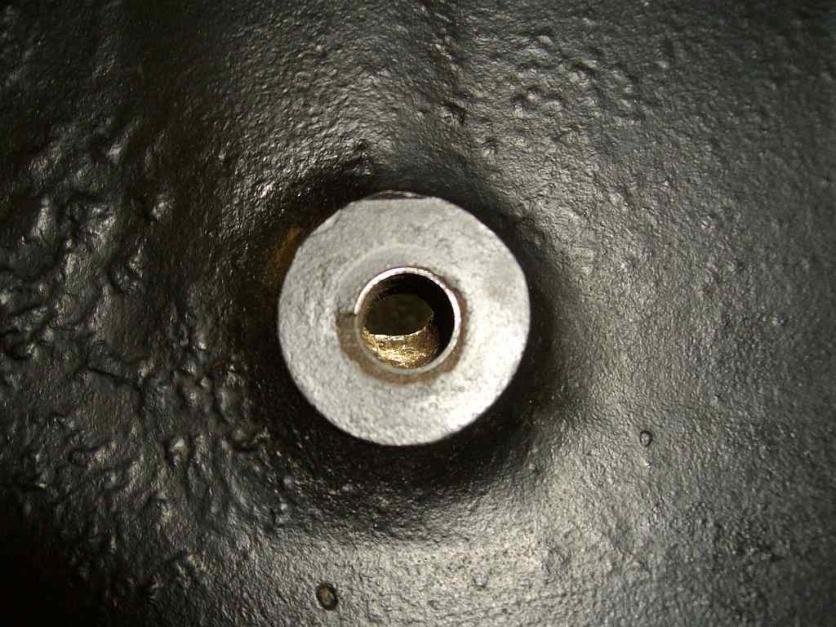

NeedsCleaned.jpgcleaned_up.jpgtap_hole_outside.jpgHere's a few pictures of what you may be dealing with. My first picture is after I removed the liners and the rust is obvious. The next pic is what it looked like after a little work with a wire brush on the end of a drill. The pic from the outside shows that the passage in the block is not a complete hole, that is, it slopes towards the underside of the FO8 gasket. It's as if that 'depression' was made as an outline of a finger pressed into the tapped hole. I think if your passage is very rusted, you could take a small drill bit, and use it to remove the rust being careful not to drill into the block -which is much harder and you should easily be able to tell when you are drilling rust, and when you are drilling steel.
