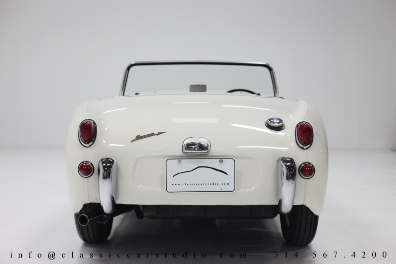

This one is so perfect pics look Photoshopped. Back end way up in the air. It looks like a museum piece not a driver.
amazing!!!
Is pretty but photos of a white car on a white background are not ideal.

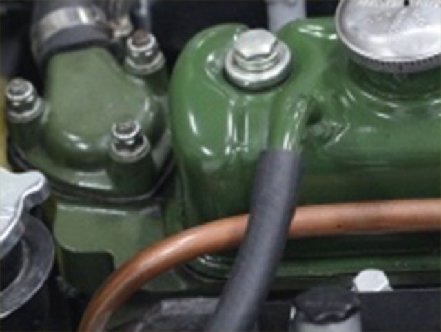

Hmmmm... So nobody has noticed that the lower end of the rear wheel arches have been clipped? Take a look at the the boot floor pan between the gas tank and the rear valance. This car has taken a good whack to the back end. I'd be very concerned about how much bondo and patch panels make up this car! Wrong VIN ID?... that's not a letter/number used on on the A-pillar tags. I'm not sure how much is the rear end being too high as much as front end kinda low. The front spring looked to be very compressed for some reason. 20 large and no sway bar and vinyl lifting of edge of dash?... hmmm... The description states "1250cc" which I thought is just a lack of knowledge/guess by the seller, but that's not a 1275 head (nor valve cover) I'm seeing, so the block won't be either. It has an aftermarket fuel tank and Facet pump too (those babies are noisy). Looks to have an aftermarket side moneyed oil filter, and I see no evidence of a tach drive, though tack looks correct/original. They got the wipers sweep correct for RHD at least.
What I see is a nice paint job and a lot of new parts... doesn't look like an honest presentation to me.

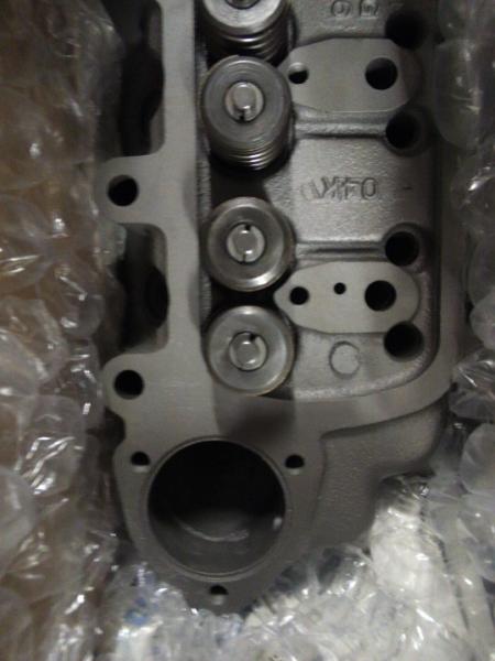

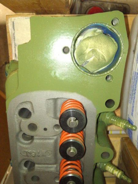

BMC Green head head pictured is a 1275, gray head is a 1098. Last image from ad photo gallery.
Can't stand it when the underside is painted black... and this case it's only the very bottom surface (and up around the gas-take).
Good catch on the rear end damage, Gerard!

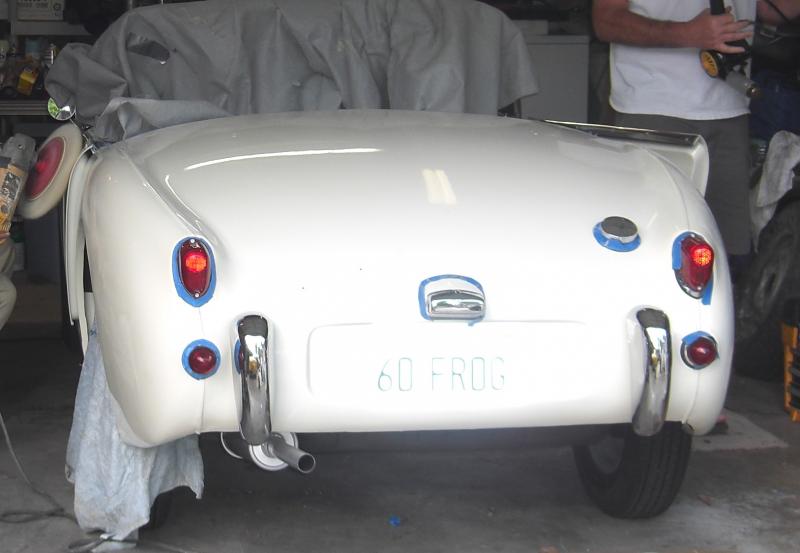

Here are two pictures....first of my "old" car, and the second of the subject car

Did you notice that the license plate is significantly off center? Also, I on't know if it's an illusion, but the recess for the plate doesn't look correct either... appears vertical lines have too much curvature.
Nominees to look at back end of Bugsy II. He took a shot in the rear ended and a complete rear clip was installed. Not that I will change things anyway. Looks like body an took liberties to trim and fit those hard to fit areas.
