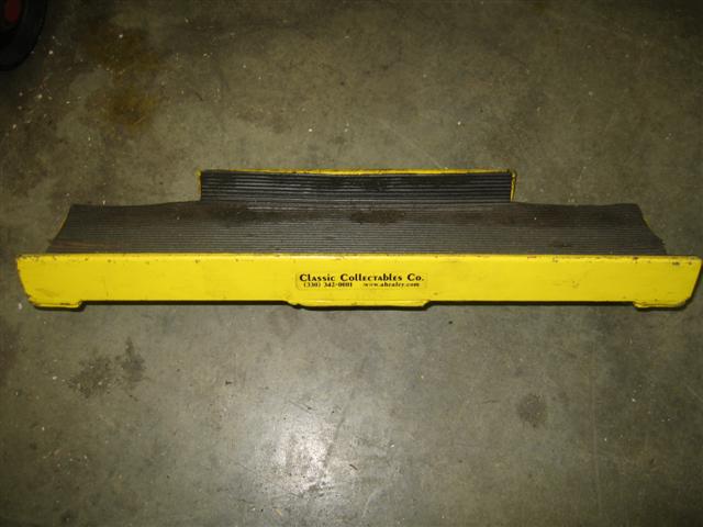

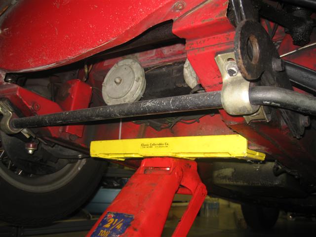

Scot--
A few years back I bought the jack saddle shown in the attached files from Lin Cline's "Classic Collectables Co."
Lin has since retired but you can easily weld up a similar saddle. It replaces the saddle that comes with most floor jacks (there is a 1" pin on the bottom not shown in the photos) and it fits perfectly under either the front or rear cross-member and spreads out the jacking load evenly without denting the metal, etc.
That's a nice tool Michael!

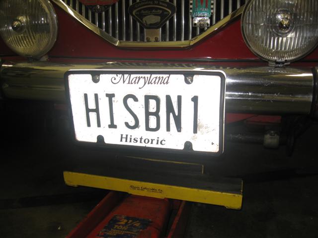

Do you also use it on the aft cross member to jack up the back?
Yes--it is cut to "encase" either cross member front, back and bottom.
I took your original question as enquiring how to jack a car and "four point it"--that is, support it on fixed jackstands in a garage, etc. versus jacking merely to change a tire. I use a trolley jack as shown and four jackstands --two under each longitudinal frame rail about where the axles are to replicate loading. I carry a scissors jack in the car for jacking on the road.
