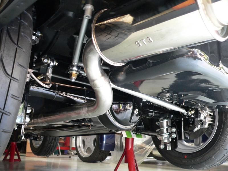

For me the Harley muffler is way to long. I wanted something to fit in the small rectangular space beside fuel tank and stay parallel to the floor of the car. In order to do that you need an S bend to bring the pipe up to the muffler.
If the Harley muffler you're using is too long then you're using the wrong muffler. The one from the sportster fits perfectly with the straight pipe.
