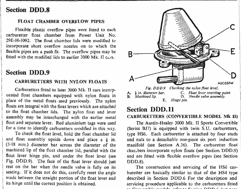

Can someone tell me the correct adjustment for the float hinged lever for an HD8 (BJ8) carb. I know you can place a drill bit between the float chamber cover and the hinged lever, but I can not remember the drill bit size for the HD8 carb adjustment. 7/16??? maybe. Don't have my manual handy and had a leaky float.
Looks like 1/8"
Yes 7/16" drill bit is correct for the HD8 carb.---Keoke
