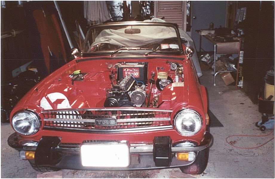

I did mine 5 years ago with Plastikote rattle cans. I sanded, used etching primer, sandable primer , then three coats of red & two coats of clear. It's not perfect but it was enough to win several first & second place awards.
Another great tip I learned from others is to use tin foil to cover things I want to keep from paint. It conforms to any shape & removes easily.
Your pictures were an inspiration back several months ago. It was harly belibeable that the work was done with rattle cans. Eventhough my current project is a Jag, I would be more than happy if it turned out as nice as your efforts. Color matching will be by fate; at some time well into the future, the car will be repainted the original white color Jag used in late 50's.
