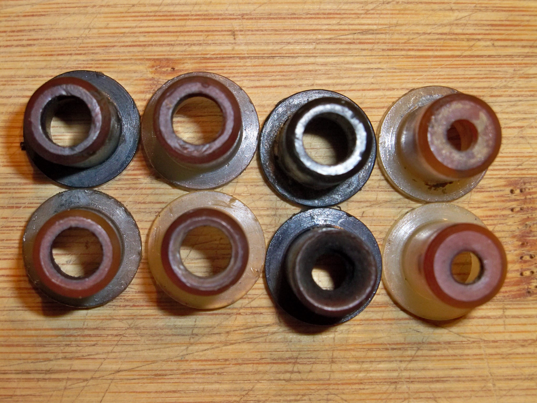

You'll find that they used plastic adapters to make the hose connection to the carbs and maybe to the carbon canister as well
