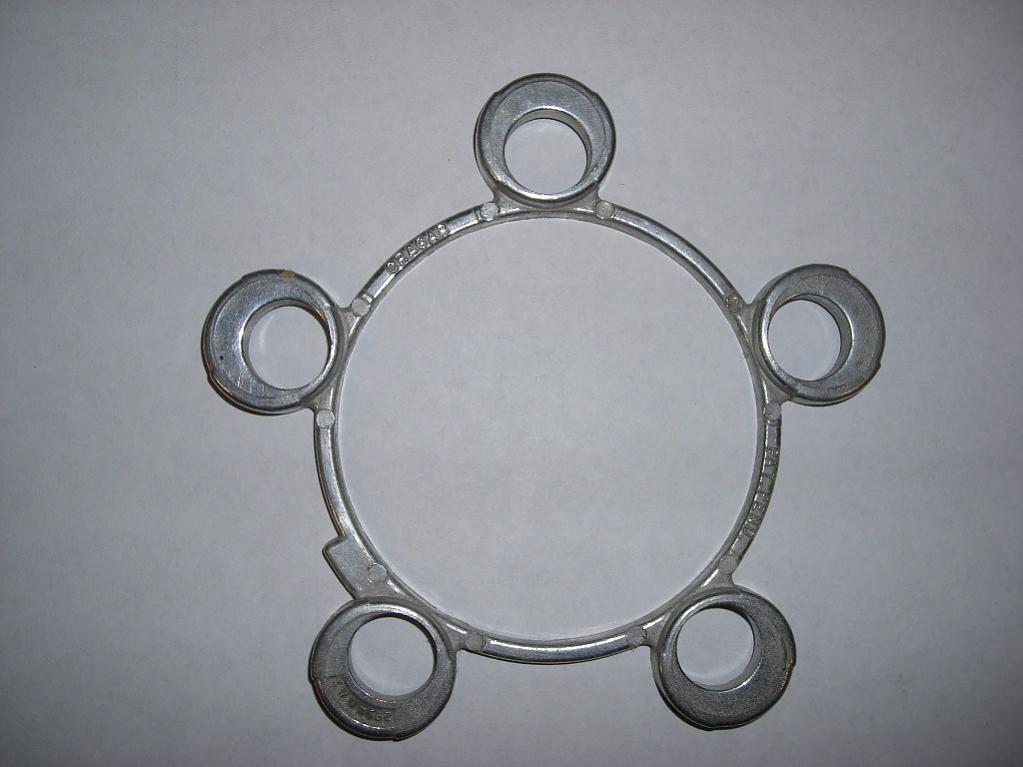

I do wish this thread had not been truncated in the upgrade, but, it was. There was a photo posted of a ring with five circles around the edge. Fragile, pot metal.
That was NOT a Unilug adaptor. It was a wheel spacer, especially if put between the wheel and hub as stated in the original posting.
Using cast pot metal pieces like that, while quick, are not very good. Machined steel with specific thickness throughout is far better.

Thanks for the clarification Dave - I did see the pic
Here is that picture. The "spacer" is not pressed between the hub and the wheel. It resides in a female recess (in the back of the wheel) shaped exactly as it is. It acts as a locator for the shouldered lug nuts. Different spacers were sold to allow the wheels to fit different bolt patterns. If the Cragar SS wheels that JP is considering are of this style, they will not be able to be fitted to a vehicle without them. TOC, the lug washers you referenced came out with the Keystone Klassics wheels. Those washers will barely work with this style of Cragar and I don't see how one could ever install them with no run-out.

I had these wheels on my 69 Mustang back in high school. What I remember is the offset washers were separate and went on between the lugnut and the face of the rim. If the bolt pattern was small, the "fat" portion of the washer pointed outward. If the bolt pattern was big, the "fat" portion pointed inward. Maybe I was lucky, maybe I was dumb and maybe I was lucky and dumb, but I never had a problem with them.
