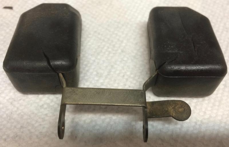

Got a call from a friend about a sudden rich running problem with his ’64 Tr4, strong smell of fuel, sputtering, etc. I told him to stop running it till I got there.
When I got to his place there was a strong smell of fuel inside the garage were he kept the car. So being on the cautious side I told him that we should push the car outside to troubleshoot it.
After starting the Tr it did’t take long to figure out the problem since fuel was dripping out of the front air filter, onto the lower inner fender and the ground….

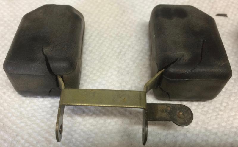

So we took the front Z-S carb apart expecting a stuck needle valve but instead we found the float assembly cracked wide open! So as a precaution we took the rear carb apart to see its condition and we found another cracked float assembly, not as bad as the front’s, but still cracked.
As far as my friend knows these floats are original to the car (he has owned it since 1967) so they could be 55 years old.
So the car is out of commission waiting for replacement carb floats.
Wonder if the replacement floats will last 55 years…..
