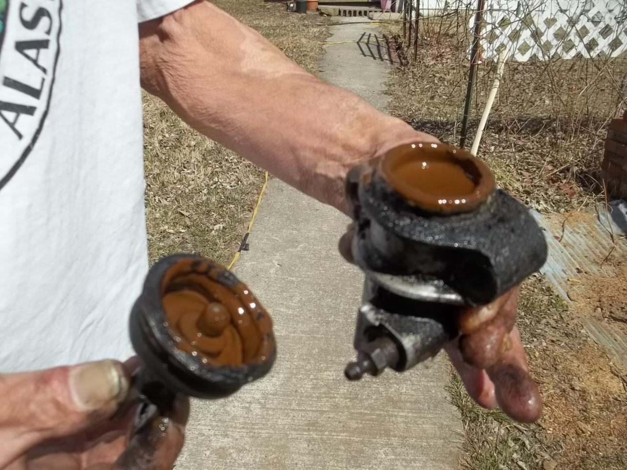

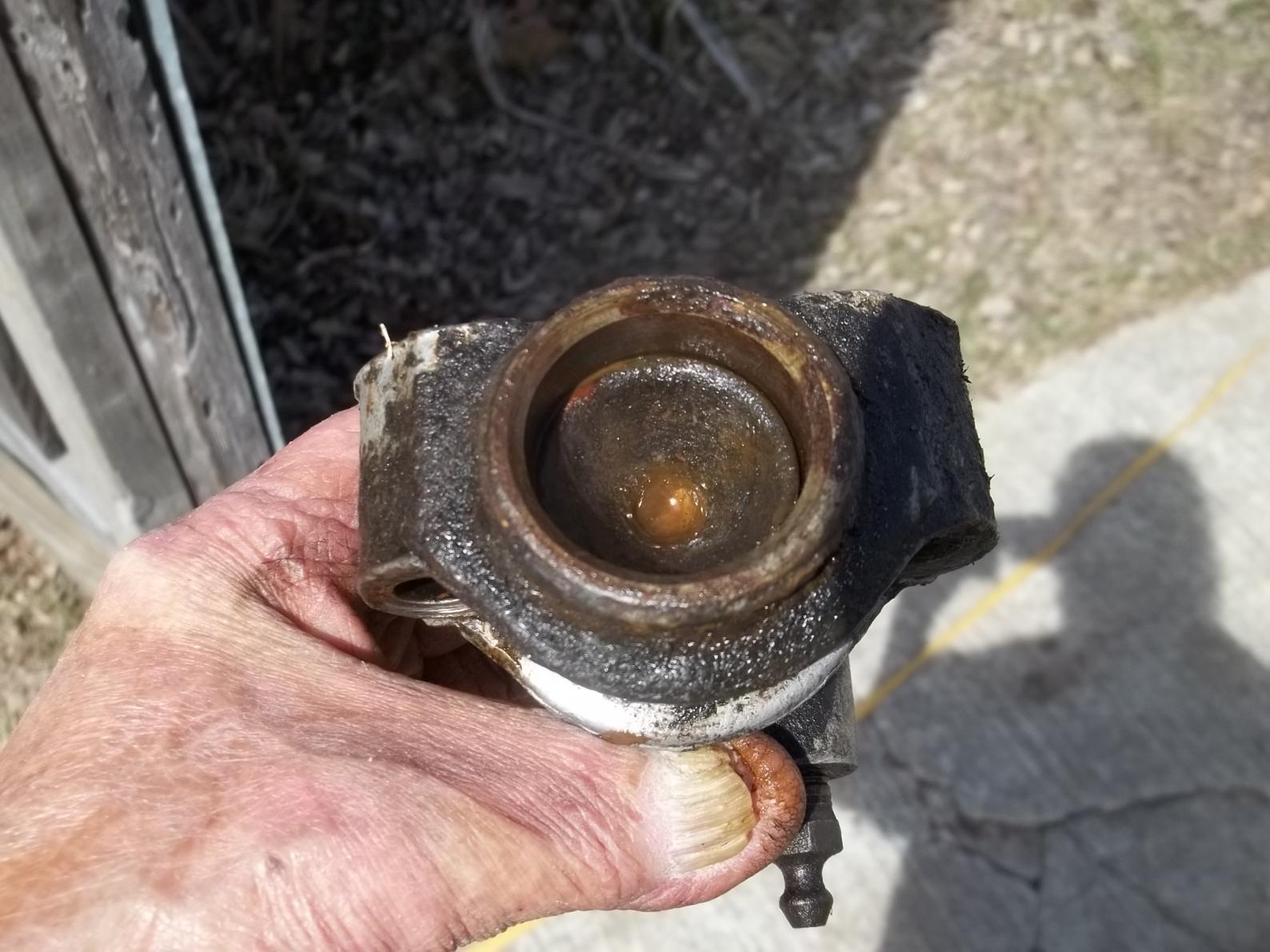

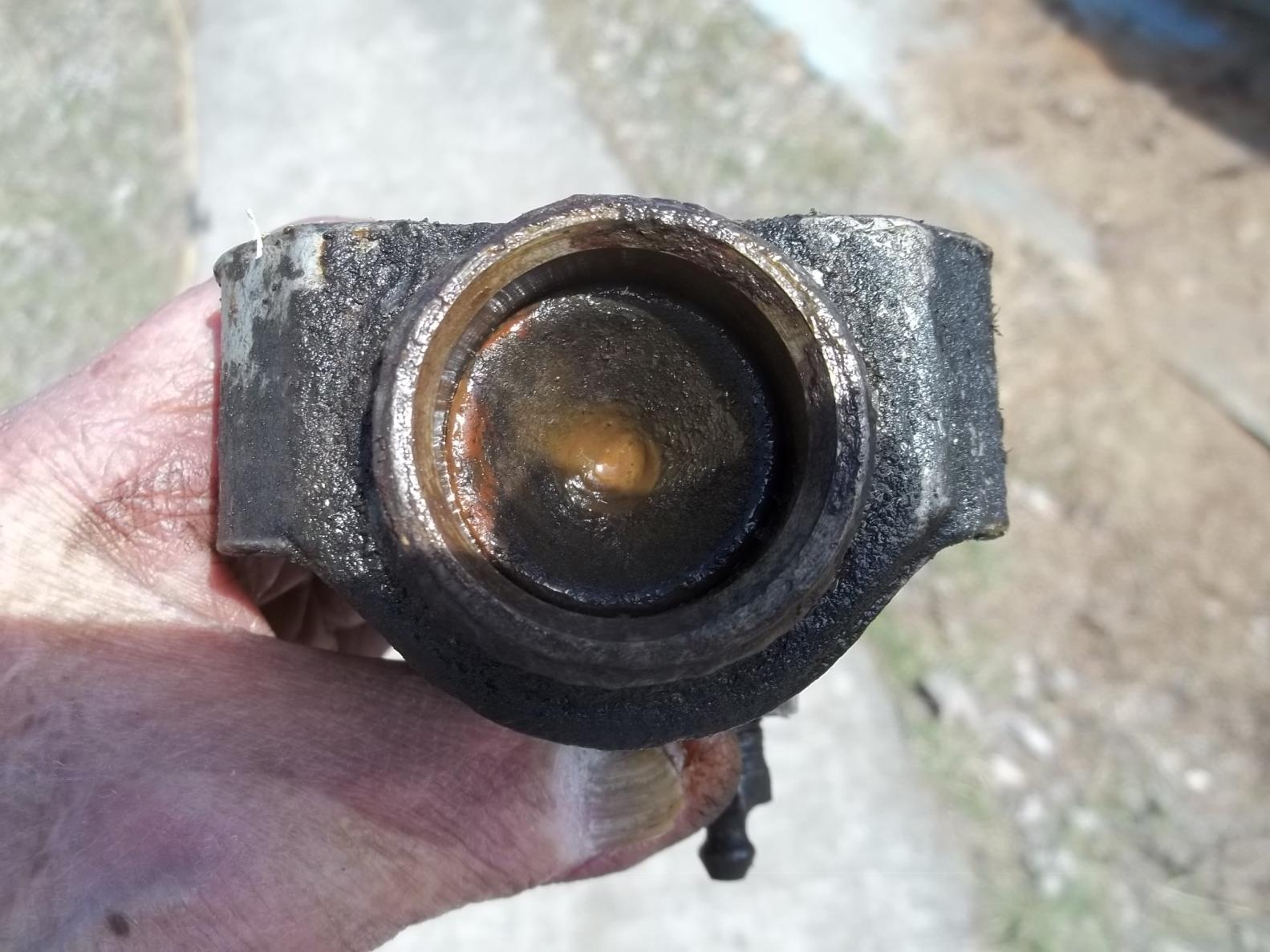

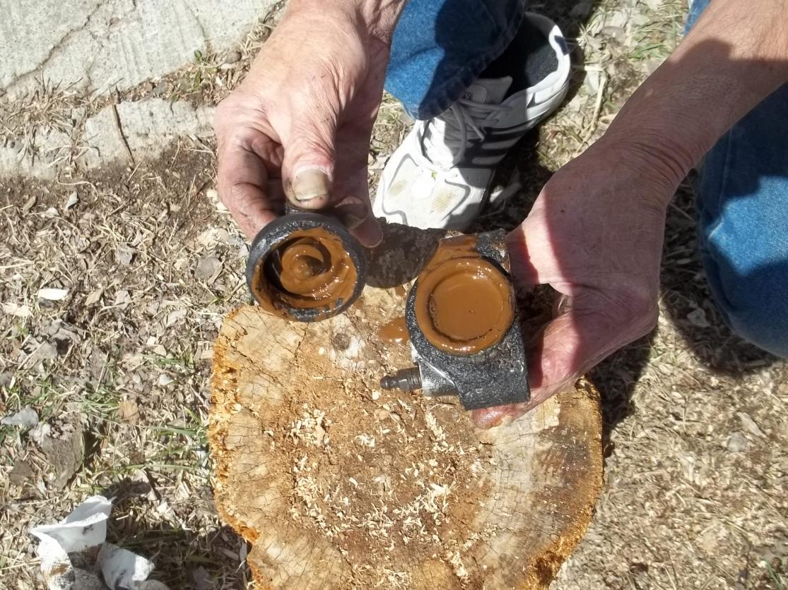

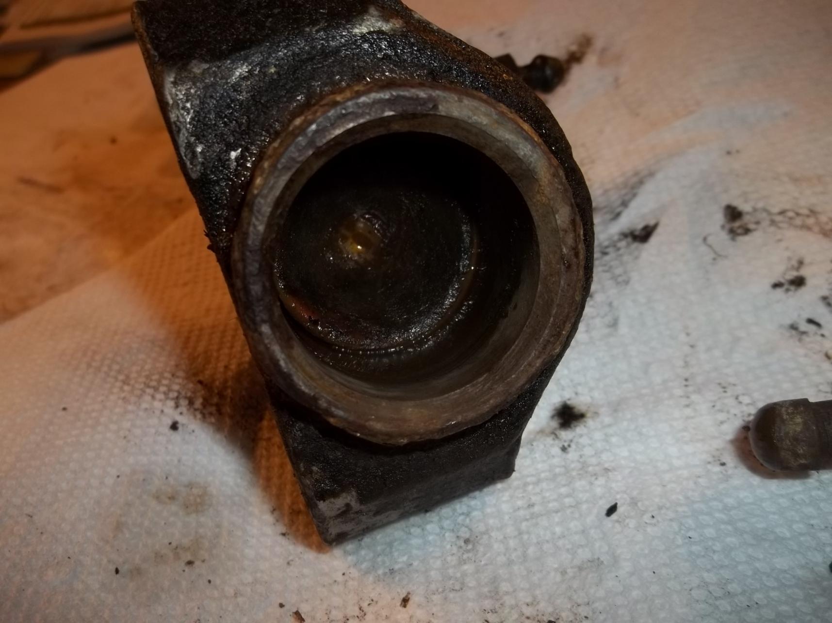

Well, what with heart attacks and operations I'm just now getting around to the Clutch slave cylinder repair. It was~sometimes~refusing to go into any gear and the fluid was slowly leaving. I have the slave off and appears that the PO did weird things there in addition to all the other weird things he did. I'm planning to order a new one on Monday if I can figure out what parts come with the new one and what parts don't. I'm attaching some photos of what I found...unbelievable !! Also, no cotter pin in the fork clevis bolt and the spring is not there. BTW where will I find line wrenches to remove the hose from where it attaches to the hard line? And does anyone know the sizes I need? I'm really a PI aren't I? :eek: Thanks.

Like the news woman on Saturday Night Live used to say after screwing everything up..."Never Mind". What I should have done in the first place was just give the slave cylinder to Carla and say "Can you figure out how to totally disassemble this thing and decide what parts we need?" That's what I finally did and now all is well and I know what I need. Sure was a lot of nasty fluid in it though wasn't there?

Hey, did anyone notice Gary said it worked!!! Swamp mud must be cheaper than what I have been using.
Amazing little cars.
Wayne
Yeah Wayne...just pump them full of swamp mud and they work just fine !! :smile:
