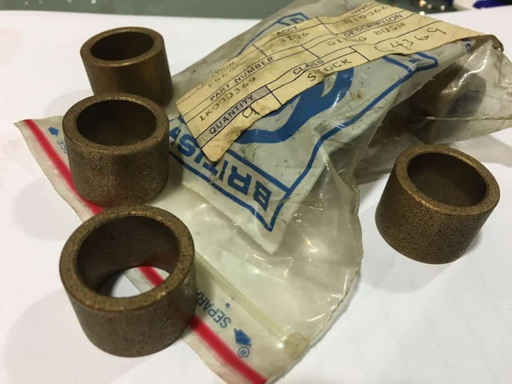

Hello, I need to replace the pilot bush in my 3000 Mk III engine.
I've found some NOS clutch pilot bushes.
Moss has reproduction ones.
Any reason to buy one over the other?
HI TH, NOS hardware will probably fit,
sometimes replicas can give U a fit.
I agree, I always prefer NOS where available. I suggest you read this Oilite technical bulletin and correctly re-oil (2nd page) before installing because you don't know how long they have been sitting. Oilite Bushings

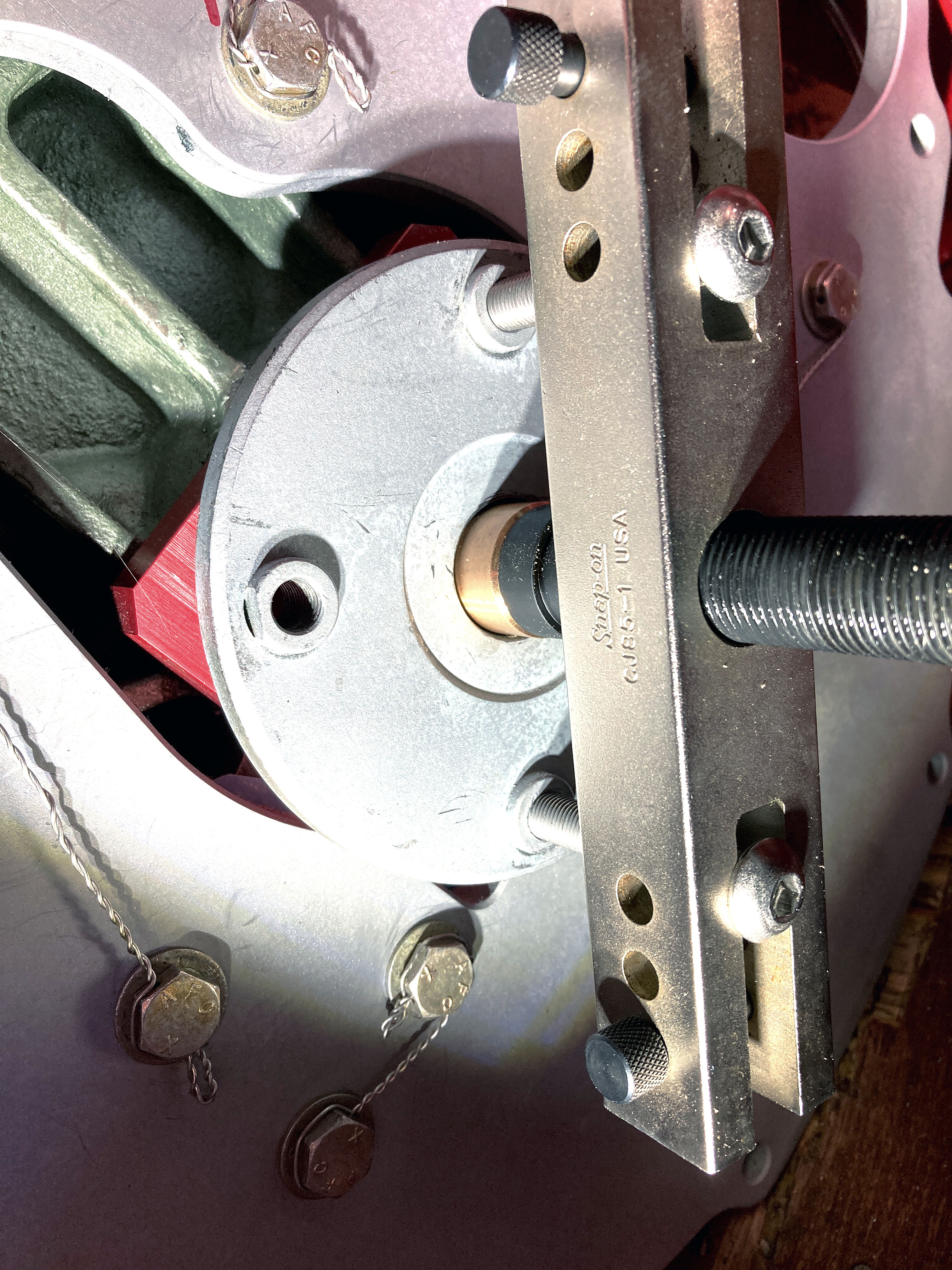

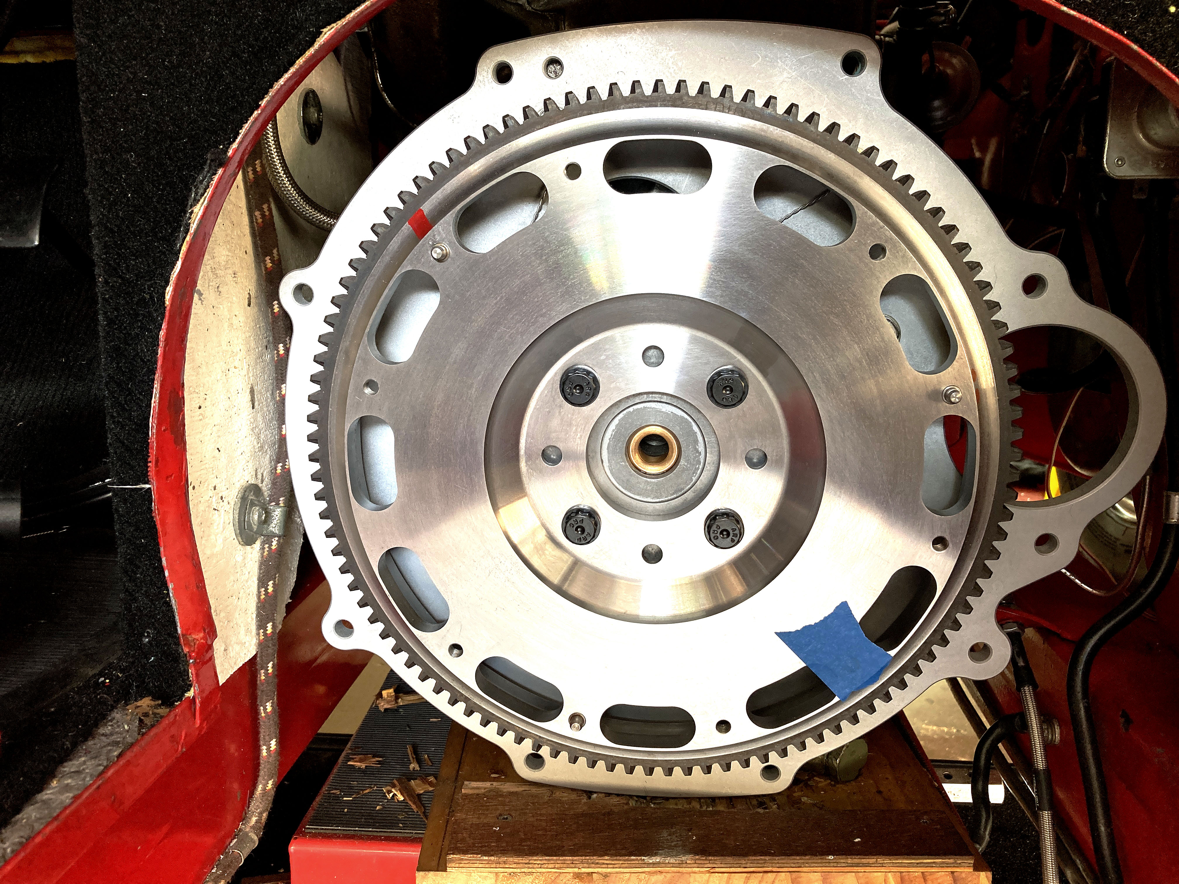

I always use a gear or pulley puller to install pilot bushings. As with a hammer, a socket or bushing driver can be used with the puller to gently press the pilot bushing without stressing the crankshaft by pounding on the bushing. It works very well.
Regards, Bill
EDIT: BTW, Hot Rodders used to put a thick felt pad saturated with oil behind the Oilite bushing to keep it from drying. And, use a bushing with no or low iron content to prevent damage to the input shaft.
Hi AUSMHLY.
Just a followup picture with my spigot bushing installed. It looks a little different than your because I am using a different diameter input shaft. And, as you know, make sure the inner diameter has not closed during installation. Spigot bushings can be anywhere from 0.001 to 0.003-inches larger diameter than the opening in the crankshaft; and this can sometimes affect the inner bushing diameter after installation (which can be opened again with a drift or reamer).
