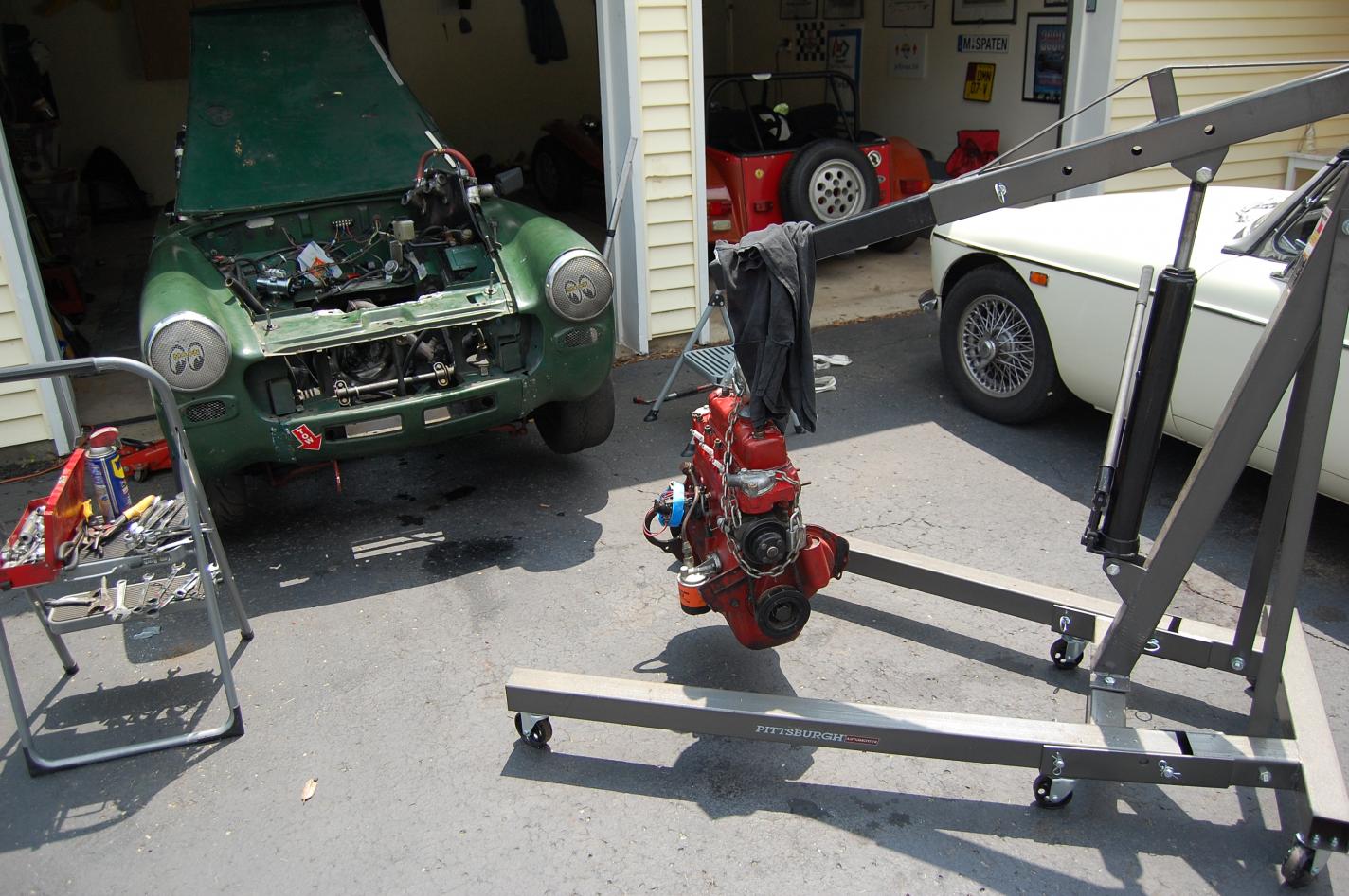

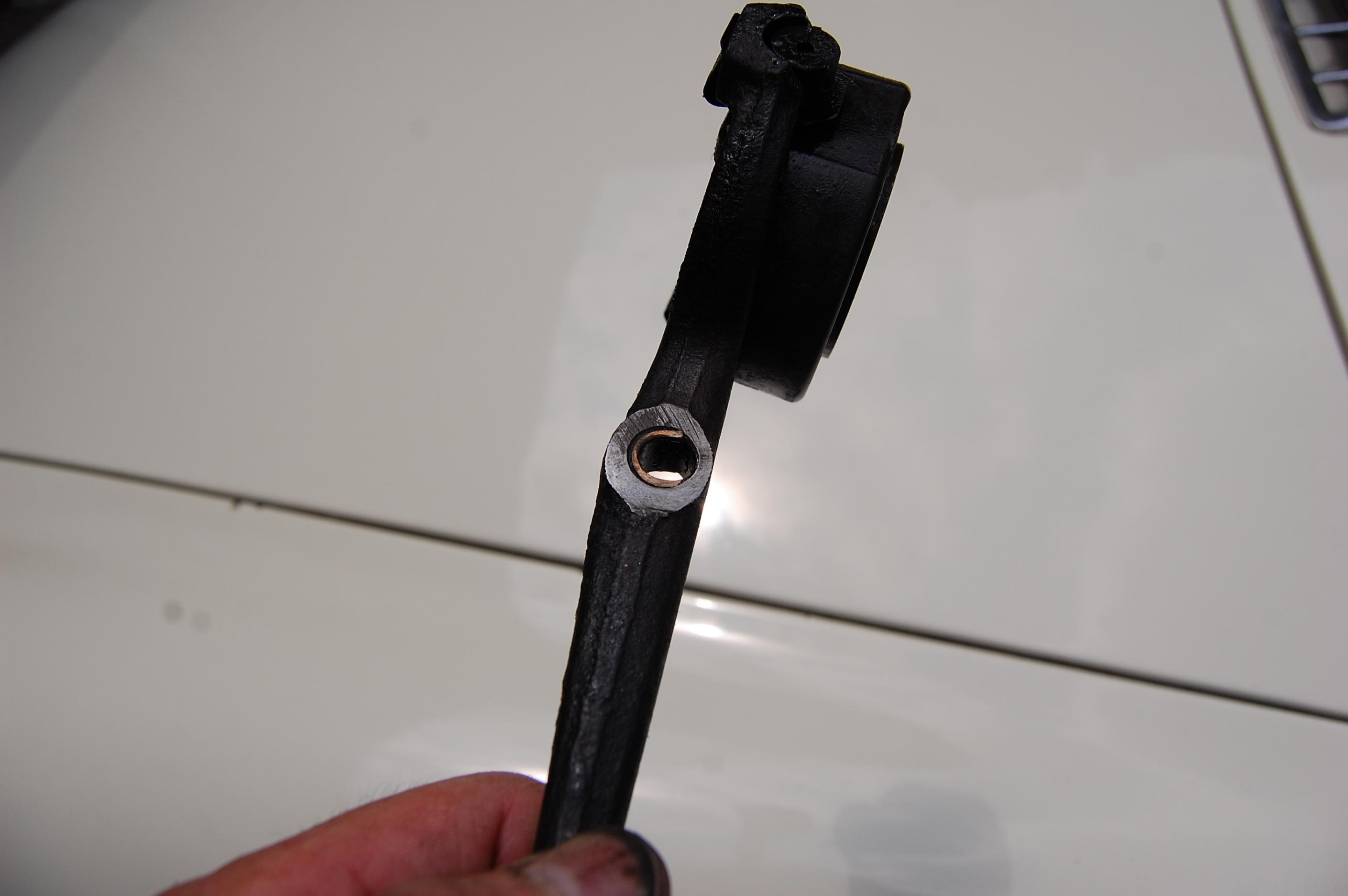

Today, I pulled the motor. The problem turned out to be a worn bushing in the clutch release arm. I have a good used one I'll install. And I'll put in a new throw-out bearing and clutch plate while I'm at it. Should be done today or tomorrow.
You can see the worn bushing in the first photo:

Nial, I think that is past the, "Slightly Worn" stage! :highly_amused: PJ
I'd say that part has done its job and given its life for the cause.

And yes, this clutch release arm bushing has done it's duty and needs to be retired!
By the way, my car has a roller bearing throw-out bearing. It was installed in a used trans I picked up years ago. I used it as is but I wonder if there was a problem in the geometry of the setup? The roller bearing is much thicker than a carbon bearing but was using the same slave cylinder rod intended for the carbon throw-out bearing.
In any event, I intend to use the correct carbon throw-out bearing and correct rod (2-11/16") with a good used release arm. So all should be back to the factory set up now.
