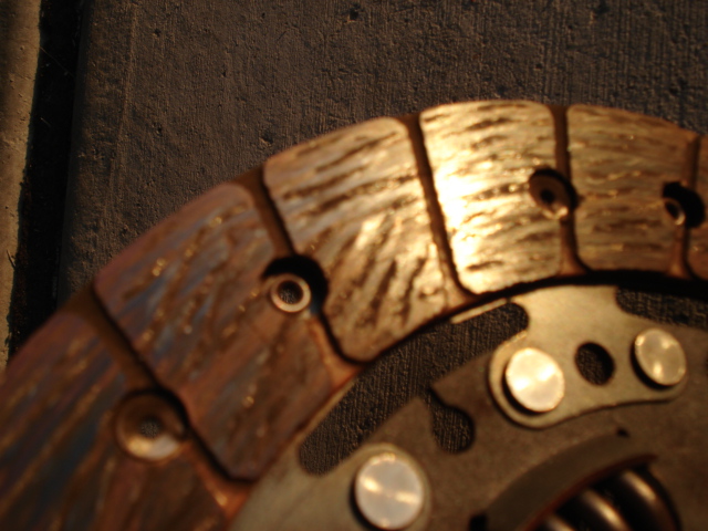

I just measured the Borg & Beck disc that came out of my TR6 with 800 miles on it and it has 10/32's of material on it. You are in good shape for material, but how is the surface? Shiny or glazed? Any heat cracks? Is there ant blue color on the pressure plate or any burn marks? Does the PP look glazed or have any grooves in it? How is the flywheel? Any burn marks, blue spots, cracks or glaze? Did the car shudder or shake when the clutch was let out?

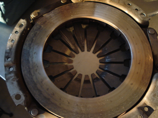

I'd say it was shiney and glazed. I noticed that there are some peculiar gouges/streaks on both sides of the driven plate (heat streaks?).

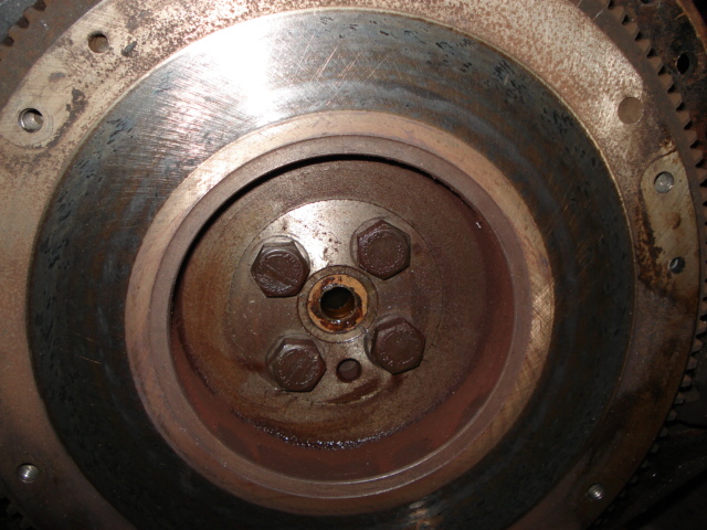

Here is a picture of the flywheel. My wife and I agree that there is a blue-hue to it. What does this mean?

Take it off and have a machine shop resurface the face we are looking at to get any hot spots and high/low spots cut down. That will be a good time to replace the pilot bearing and rear main seal.
