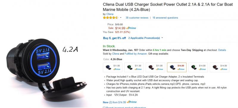

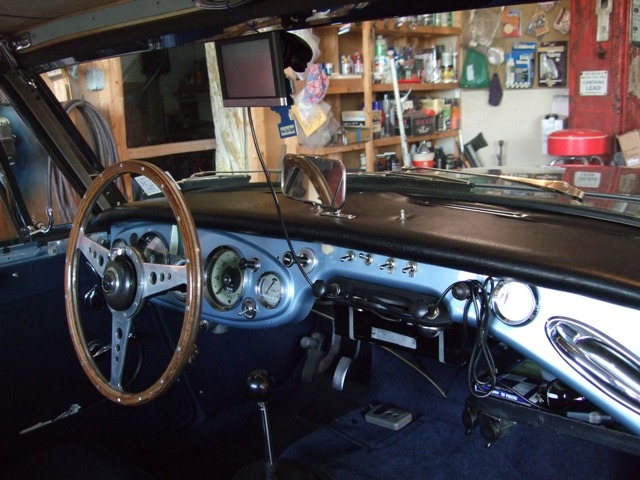

Steve, I love the little panel that your USB socket is affixed to. But tell me, since I am not much of an I.T. guy, I assume that the USB jacks are for charging purposes but am curious that they are marked 5v. If at 5v what method are you using to reduce the voltage and why? Also please, what are the little dials for to the right of the UBS plug? Thanks.
Evidently USB uses 5 volts. These chargers step it down from 12. I bought mine in a store but this one is similar:
The left knob is an infinitely-variable speed controller for my fresh air blower (pulse-wave modulator); the right knob is a selector for my two o2 sensors for my air-fuel meter.
