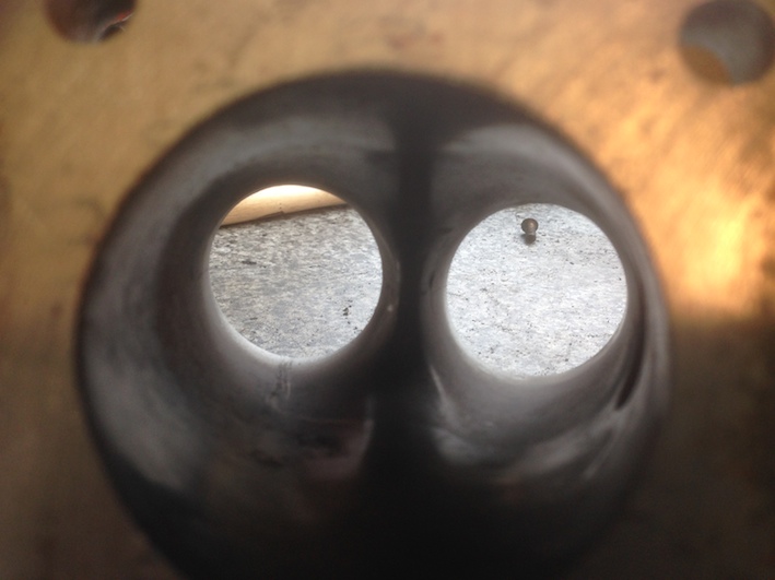

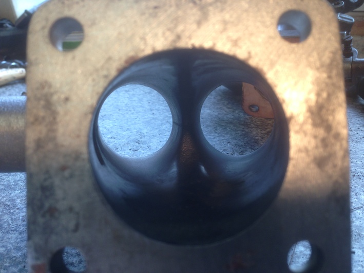

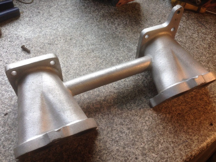

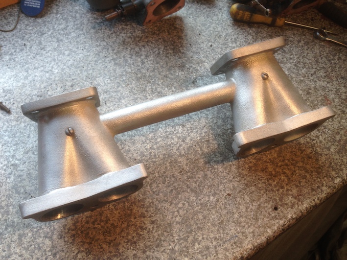

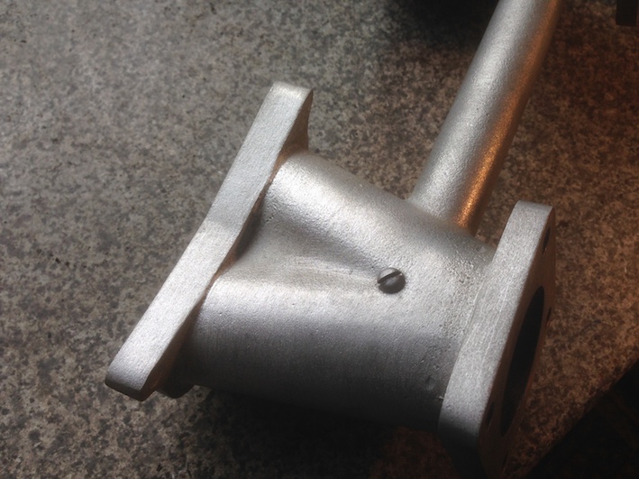

According to the BMH certificate, my 1960 TR3A was supplied with competition springs and dampers when new. It also seems to have some other goodies to, including the non standard inlet manifold. It has no identifying stampings or numbers cast into it. Does anyone recognise it?
I have spent a few hours trawling the Internet and think I may have answered my own question. It looks as if it could be a SAH manifold. According to this old add they were supplied as a set which included a modified head. Have a look at this link https://www.oldclassiccar.co.uk/sah-triumphtune.htm
