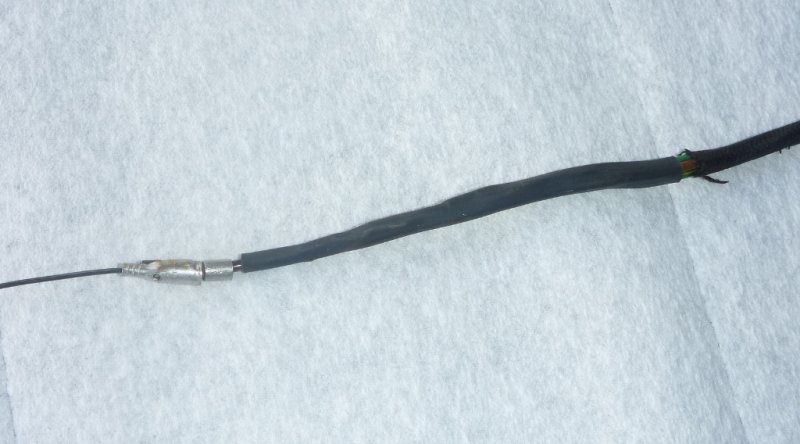

I pushed a length of bailing wire (with a female bullet connector attached) up the tube and used it to pull the stator wires down.
Removed bullets 2 - 4 from stator wire and put heat-shrink tubing around the loose wires. Easy to pull through the tube:

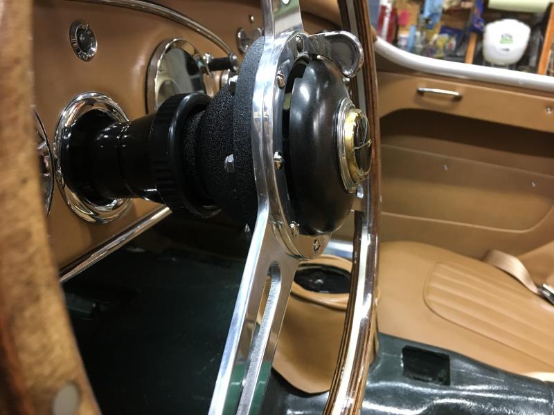

well i got it. i had to run my wire up from the bottom and hook to my harness. then i braided the wires and covered in shrink wrap. heated up the wrap and pulled them thru. my hub does not quite pull up tight to my steering wheel. appears the boss is not deep enough to let it come all the way in. it may be they want to make sure the blinker switch does not hit the screws? anyway here it is.fullsizeoutput_17a.jpg

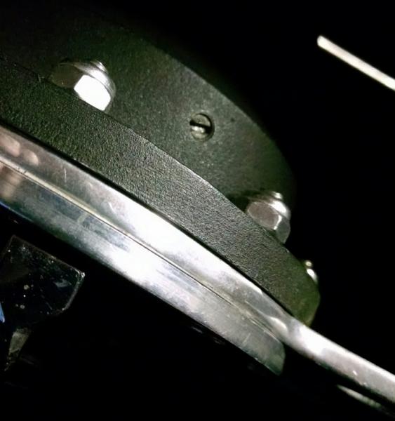

Picture 2 above looks like the 3 grub screws in the hub need to be backed out enough to push the trafficator backing plate in fully, then loosely tightened to retain it.
I had the screws out totally trying to push the unit in. The wheel came from AH Spares and the boss came from Moss.

I am going to measure the original boss and see if they are the same depth. It is definitely in the boss that is holding it out.
my backing plate is all the way up against the lip inside the boss. So i either have to make the lip deeper, build the steering wheel out, or leave as is.

In my opinion the best possible solution to your problem - you could make up an aluminium spacer complete with fixing holes that is thicker than the one you have at the moment that bolts the wheel to the hub, done properly it could be a neat answer.
Now considering that you have parts from two different suppliers then probably neither of them would help, an alternative to my first suggestion would be to make a spacer that fits under the wheel, against the hub i.e. kind of building the hub out, the general finish on the flat surfaces would not matter too much as long as the edge was polished up, the bolts would need to be longer possibly.

i did think about building out the wheel either by a spacer behind the wheel or by a thicker front one. also measured the original wheel to the flat part the backer plates sits against. it is about an 1/8 to 3/16 deeper. Not really an AH spares issue. the problem is in the boss. Moss says it works with this wheel and they actually the cover plate with the kit. i will check with them to see if they have any suggestions.
Are you sure the tube of the back of the trafficator isn't bottoming in t slot in the stator tube? That happened to me a I had to extend the stator tube more out the front of the steering box.
i thought the small tube went inside the lower tube? but i also measured the distance to the lip the backing plate will hit. i am pretty sure it is in all the way... as far as it will go anyway.
DD - Following John T's thought...
For grins, why don't you loosen the olive nut on the front of the steering box and pull the stator tube about 1/4" toward the front of the car and see if your trafficator then seats properly.
The steering wheel and its outer ring have nothing to do with this issue - it's all about the relationship between the trafficator and wheel hub. From your pic, the wheel clearly bolts up to the hub properly.
What I wonder is how could Moss be selling a hub that doesn't fit a standard trafficator - just don't see that happening.
