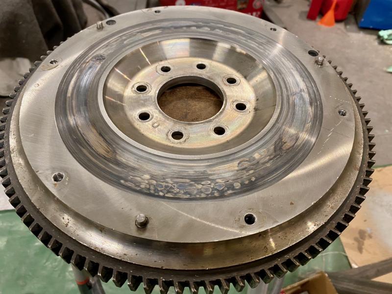

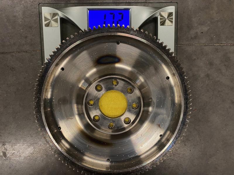

Anybody have a diagram of how they would lighten their flywheel? I have a machinist, but he wants some hints.
Thanks Doug, I had looked at that site before. It shows some of the area to trim. I am not sure how they carved out around the mounting holes. I assume with a milling machine.
Hi Jerry -

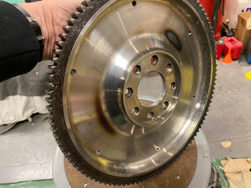

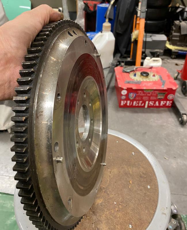

Here's a few photos of the lightened stock flywheel I used on my vintager racer for years. You could use this same design for the street, just leaving a little more material on if you didn't want it as light. I think 25 lbs would be a good streetable weight.

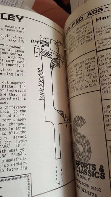

Good pictures Doug. I also was sent a very old healey magazine which gave how much metal to cut off, ie. 1/8 at the outside corner, 1/4 on the back side curve. I will see if I can post these and we will have it all in the same place.

Hi Jerry -
Oooo not to sure about that Dougie, I took mine to Bill Rawles and he whipped about 6Lbs out of it. It ticks over well and is quite responsive.
:cheers:
Bob
Read the text first then the picture and this will make sense. Helps a lot with Dougs pictures. Thanks Doug.
You're right Bob, I miss-spoke. The wine must have been talking, I meant to say 20lbs. would be a good street weight.
Or you can go with the "Full Monty" at 10lbs which I use on my racing big Healey.

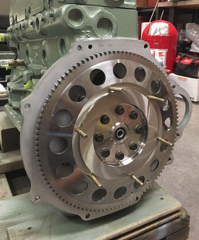

Really impressive Dougie!!!... full build specs??... or is that secret?
