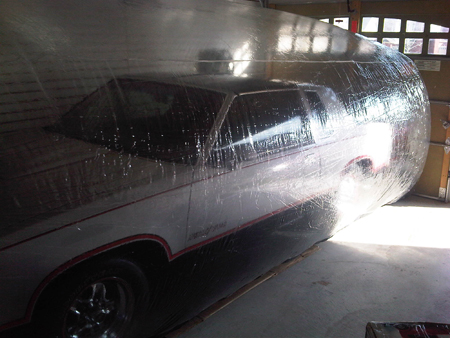

Thanks. If you're keeping the car under wraps for a year, one thing you don't want is to "seal in" moisture, especially in a humid climate. Air needs to circulate, to prevent corrosion, mold, and mildew. One possibility: a pressurized "cocoon", which removes moisture from the air and keeps it circulating. Expensive, but safely does what you're looking for.

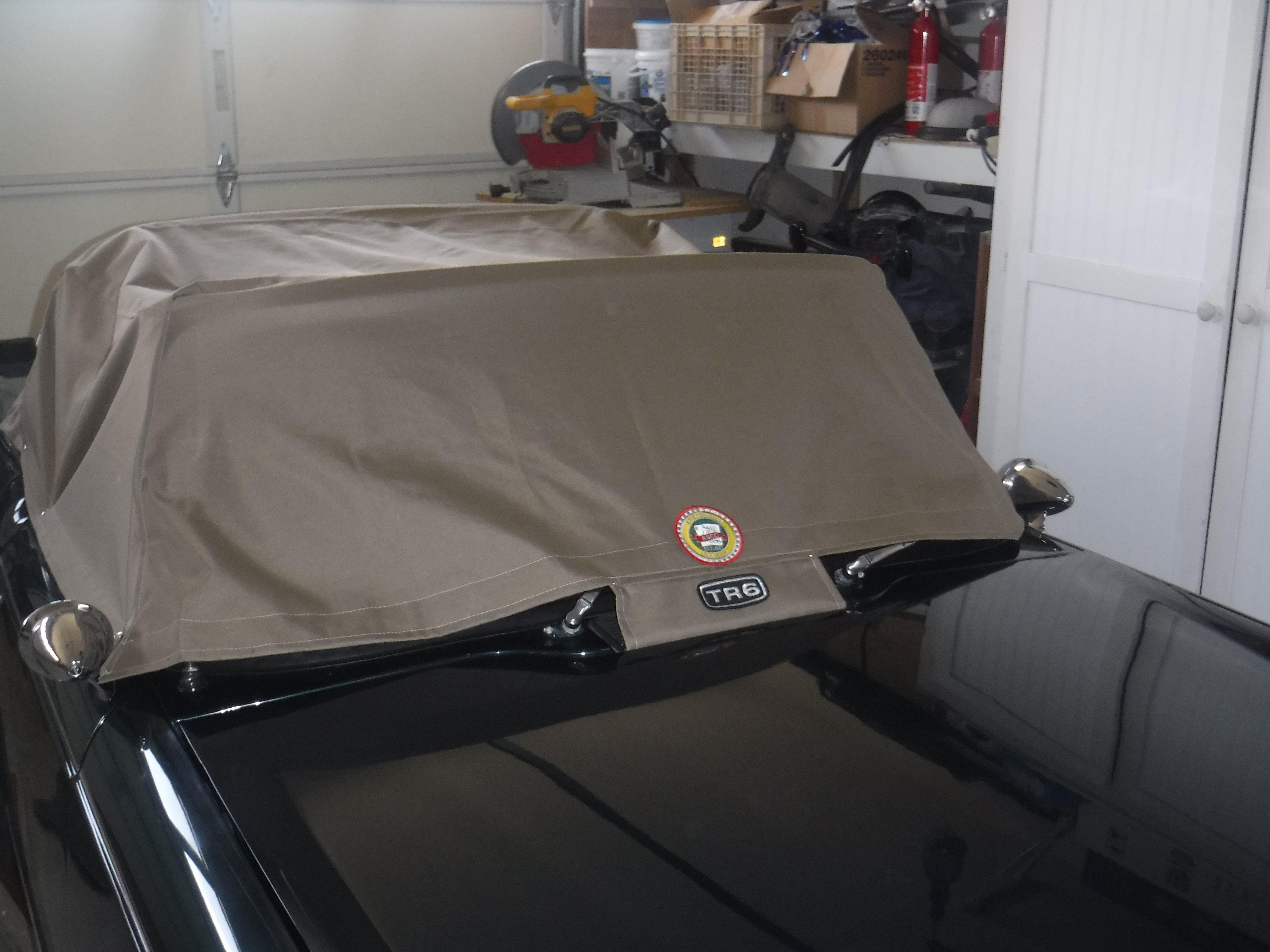

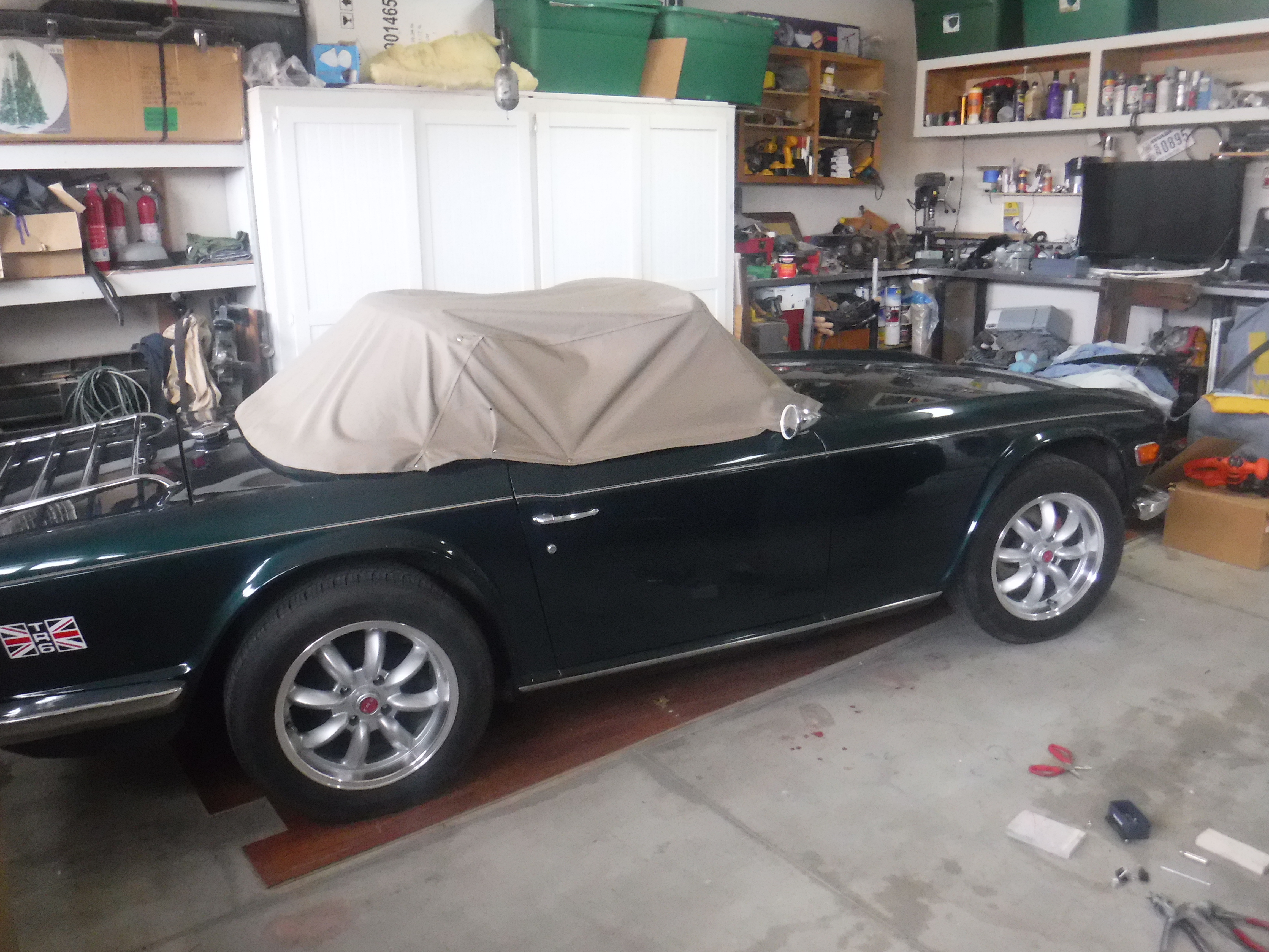

Some tips for car storage. Put dryer sheets in all spaces back front glove box seats near wires 12 sheets any place trunk. They are said to keep mice out. I recently removed seats from a GT 6 TR mice had made a home inside the seats. Tires off the ground full or empty fuel tank gas additive. no battery. even remove carpets .A light bulb may keep down moisture. Good venting I made this for my TR 6 it is water proof outside chair seats mat from on line supply $ 10.00 a yard 60 inches wide, sides are vented.. Hood holds front down by flap Keeps inside clean with out top up or hard top on. I could have made it bigger but the paint does a good job on it's own.
