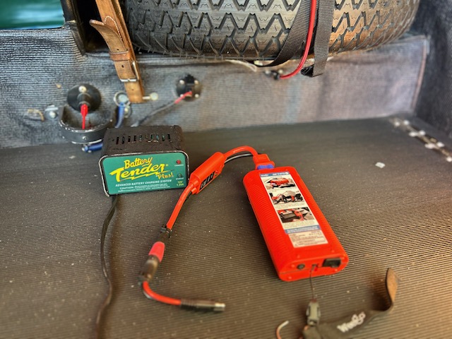

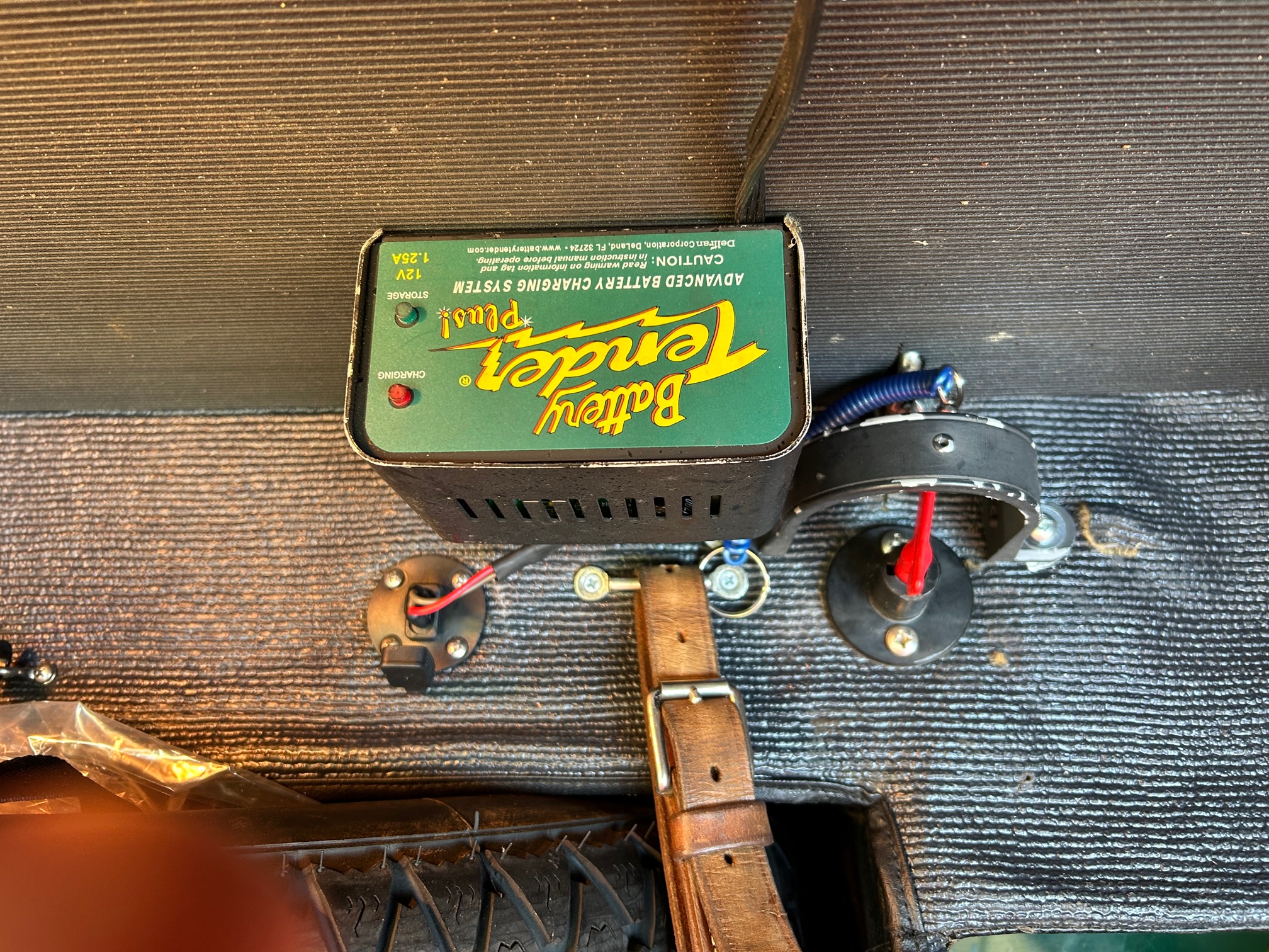

I use a BatteryTender Plus (shown)--I believe it has an output of 1.25 amps which is more than sufficient to maintain a full charge.
Because the battery is not accessible on two-seaters without removing the spare I pulled some #12 wires from it to a two-terminal receptacle mounted in the bulkhead which provides for easy connection of the unit.
I also carry a Weego N44 compact jump starter which plugs into the same inlet. Frankly I have had to use it but it seems like a good concept!
BTW the red removable key is for an aftermarket disconnect switch mounted between the battery and ground. It replaces the standard switch which is so prone to failure.

In part, because it is inconvenient to access the battery on my 100 I use a BatteryTender as shown in post #11 above to maintain a charge during periods of inactivity. If I need a charger or jumpers I attach the hot lead to a terminal with a rubber shield I have mounted nearby the starter.

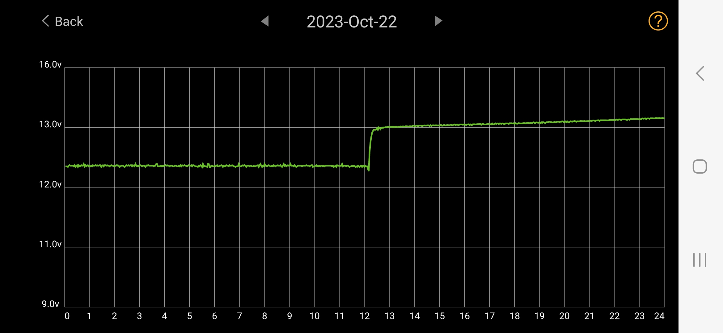

This is a voltage graph of my Mercedes battery before and after connecting a Battery Tender Plus. I had left the car sitting for over a month before plugging it in.
Less than an hour to bring it back from "won't start the car" to "ready to go". I think the shape of the charging curve is pretty neat as well. At 9am the next day the voltage stabilizes around 14+V, then at 6pm it drops down to 13.2V and stays there.
