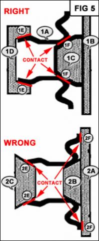

It’s a crime, but most knock-off wheels are balanced incorrectly... Tire shops will insist they know what they’re doing but in fact they don’t.Study the drawing below and you’ll see the right and wrong way to mount a knock-off wheel on a balancing machine. All Dunlop wheels (and Dayton wheels manufactured before 1990), have only two surfaces machined concentric to the rim. That’s the inside taper of the inboard side of wheel, and the outside taper of the outboard side. I visited a dozen shops in my area and they all wanted to stick an adapter (see 2C) into the outboard side. None of them had the proper adapter (see 1D).

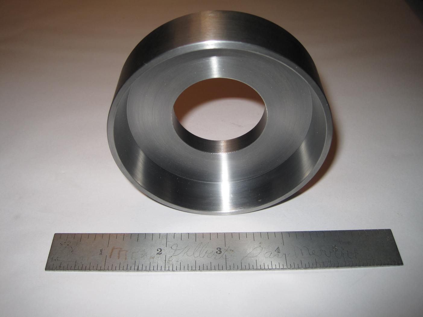

I’ve made my own adapter. It basically mimics the knock-off nut, but fits all modern machines. It’s simple and it works. And it can be sold for under 25 bucks. I’m not a vendor, but I’m wondering if there’s enough interest for me to pursue running off a quantity?

Note: The drawing is borrowed from Moss Motors literature
Edit: If you're fortunate enough to have a shop that balances your wheels on your car, disregard my big idea.:rolleye:

But they're not. And although the tapered adapter that the current machines use may not match the taper of the wheel exactly, it still "centers" the bore. Do this on the inboard and outboard tapers and you pretty well establish the proper axis of rotation. BTW my adapter does have the same taper as the wheel, so at least one side of the equation is a net fit.
