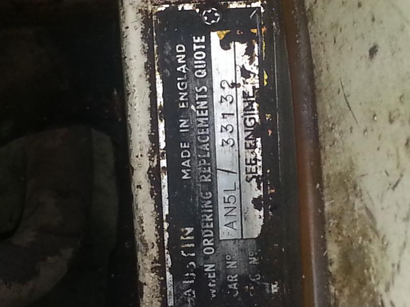

Since this is my first post, I hope it is in the correct location for the question I am asking.
I recently purchased my Grandfathers 1960 Austin Healey Bugeye Sprite.
The issue is: The title that my Aunt gave me says 1966 Austin Healey. I am almost 100 percent certain it is a 1960. My grandfather always said it was a 60, and his old registration that was under the steering column says 60 also. The VIN number is: AN5L / 33132. Is the Heritage Certificate mention in one of the other posts official enough for a DMV to accept it as credible?
Welcome. There's a dedicated Spridget section on this forum and I reposted your question there as you might get some more responses. The title is "Sprite Title Problem" Your chassis number sounds like a '60 to me and the Heritage Certificate will confirm it. The real question is one probably no one can answer, how the state will address the issue. They could be reasonable or it could be a total PITA. Do you feel lucky, punk? Do ya?
