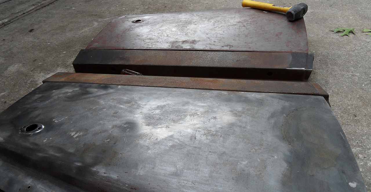

Here is a picture of a right and left door lying on the driveway and next to each is a replacement (flat) outer rocker panel. As you can see, the center of the door is slightly higher than the rocker, and both ends are flush (or slightly recessed) with it. There is not much of a curve to the door. I have two sets of pre-60k doors, and they seem to be curved about the same. The original rocker is filler, so I can't say if it was flat or curved to match.

I am just going to put a little skim coat of filler there if I find that the curvature is noticeable.
