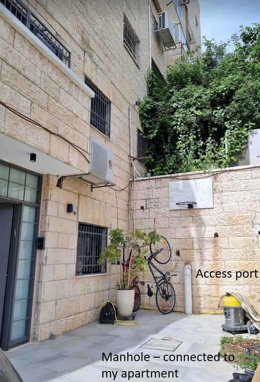

Oddly enough there is no smell in the bathroom right next to the spare room so the gas doesn't seem to be escaping through the p-traps in the shower/sink/toilet. The drain pipes from the bathroom runs directly under the spare room floor and are connected directly to a manhole in my driveway which leads to the city sewer.

Two nights ago, I opened an access port on the main line going between the front and back sides of the building. My apartment is built into a hill so I have a private entrance on one road and then at the top of the hill on the other side of the building is the main entrance into the apartment building about 20 feet higher. At the higher level.. there are a series of manholes which collect the mess and then send it through a 6" pipe around the outside of the building, to a manhole sort of directly behind the basketball hoop and then another 6" pipe which then runs under my driveway, through several manholes and out to the city. I opened the access port about 5 feet above the level of the manholes in my driveway.. just enough for it to vent. Late at night it "exploded" leaving me with a clean up job (outside)
Normally - even a peak time there would only be a "flow" in the main line - certainly not explosive force at the access point. Even when we have had our local "Rothschild's Sewage and Septic Sucking Services" clean things out there has never been that kind of pressure... they have cleaned the system with that port open. So it looks like upstream one of the manholes is filling up and eventually dumping creating a huge blast. Clearly something needs cleaning.
On my side, I most likely need to add a check valve like this which would be good to protect my apartment anyway from flooding - next week when building supply places open up again after the holiday I will need to go look at them and see if they will help against gasses.
