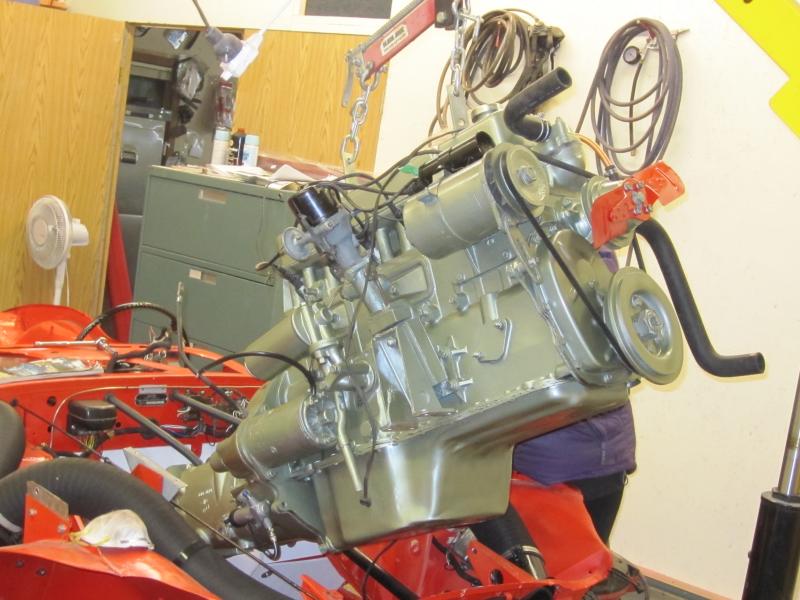

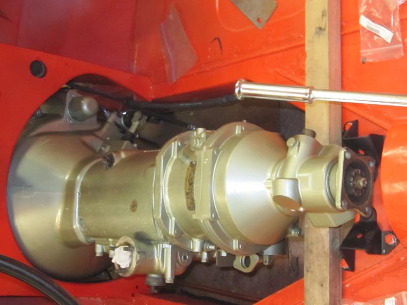

After months away from the 100-6 project, I got back at getting the engine and transmission into the car. You may recall an earlier thread where I mentioned that this engine and transmission were rebuilt, but decades ago, by some unknown person or persons. After taking various covers off the engine and transmission, everything looked good in there - with lots of assembly lube still in place. So I decided to proceed without doing a complete tear down and rebuild. I did redo the carbs, taking pieces from various contributors. The next job is to install the radiator, hook up hoses, and add oil to the transmission. I'm still waiting for new transmission mounts to arrive; one of the old ones looked quite rotted.
Although this is a correct gallery head engine for this vintage of 100-6, it seems that this engine originally came out of a non-Healey Austin. So various parts (including the rear plate, starter, oil filter cannister, motor mounts, etc) required replacement or repositioning. I wonder what I missed? As far as I can tell, Healey used the standard Austin sedan engine, modifying only what they needed to modify in order to fit it into the smaller Healey chassis. I wonder what I missed?
Most of the wiring is in the car now, and I'm not sure whether just to do a temporary fuel and electrical hookup to test the engine or whether to hook it up to the car's fuel and electrical systems first. Right now there still are a lot of loose wires from the new wiring harness hanging out everywhere on the car. Anyway, dropping the engine and transmission in is kind of exciting. Here are a few pictures.

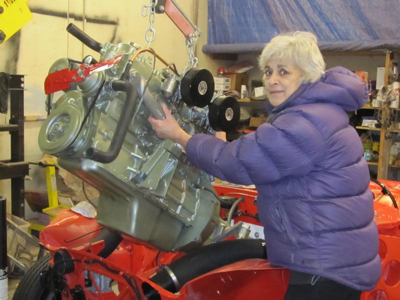

Griz, Winter is about the only time I have to work on this; summer is just too busy. The garage has a new natural gas furnace this winter, which is a lot cheaper to run than the electric heat used in the past. (You wouldn't know that the garage has heat, judging by the jacket worn by my helper in that picture - she had just come out to help steady things.)

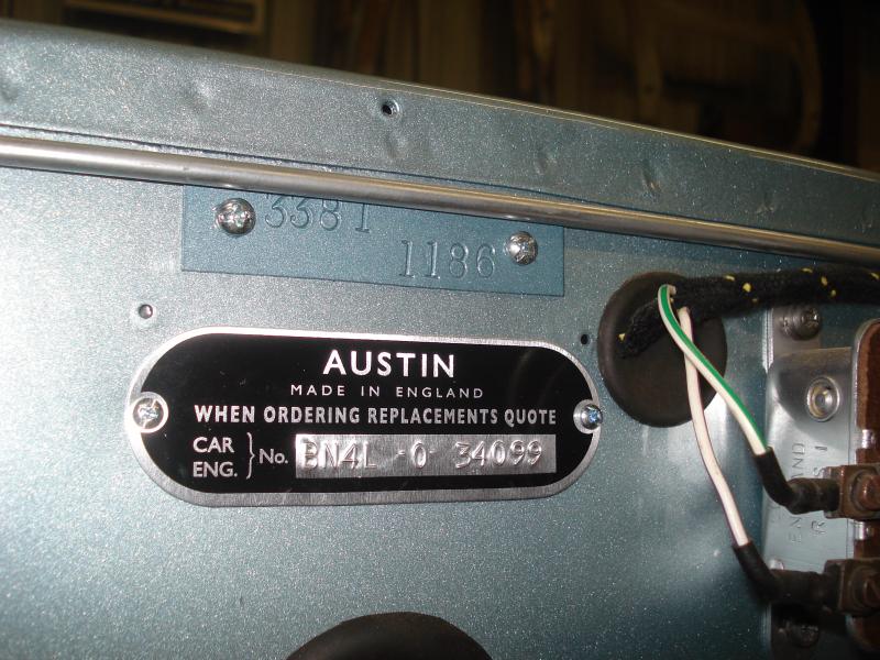

Great photos and thanks for sharing. could you be willing to share the vin and body # for this longbridge 2 porthead?:driving:

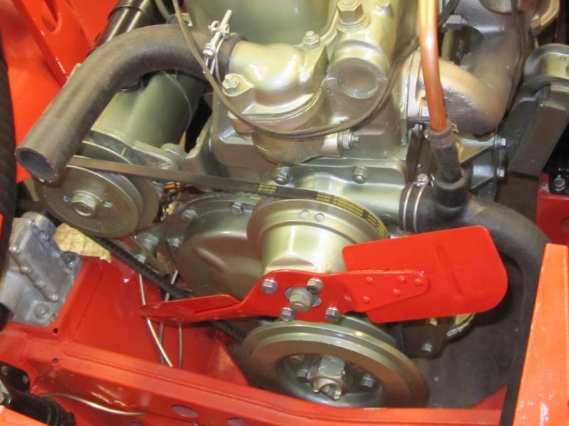

I noticed you only have a 2 blade fan. It doesn't get too hot in Canada but it would have a 4 blade originally, no? Looks good, nice big step.
healey 106 - No problem. Will have to get back to you on the VIN, etc.
healeyblue - I also wondered about the two versus four blade fan. This is what was on the engine. In wonder what was original in '57 for the Healey? If four blade, is it just a matter of adding another two blade fan in front of the existing piece, or is the four blade unit all one piece? Speaking of not getting too hot in Canada, we do get up to the 90s and very rarely to 100 fahrenheit in summer. Winters can be cold, although not so far this year. The engine still has an engine block heater, complete with a plug in cord, fitted to the side of the block. I left it there, at least for now, mainly because I do not have a frost plug to replace it with.

healeyblue - I also wondered about the two versus four blade fan. This is what was on the engine. In wonder what was original in '57 for the Healey? If four blade, is it just a matter of adding another two blade fan in front of the existing piece, or is the four blade unit all one piece? ...
Yes, just add another two blades. You'll have to figure out, however, if your existing two blades are the "front" blades or the "rear" blades. According to Moss, they are different. The blades are not at a right angle to each other.

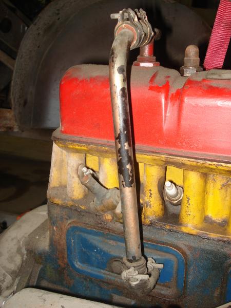

What is the tube extending down by the starter ?
It's a crank case breather tube. The early engines have an L instead of a T on top of the valve cover. Instead of having the breather run up to the valve cover and then over to the carbs, the breather just points at the ground. This may say something about the state of environmental legislation in 1957.
Car/Chassis Number: BN4-LO/34259. Body Number: 1628. Color: Duotone Colorado Red and Black. Trim: Red. Hood (top): Black. Destination: Chicago, USA. (From British Motor Industry Heritage Trust Certificate)
thanks for the info, that is a fairly early Longbridge, per the Heritage certificate was it built in 57 or actually 56.

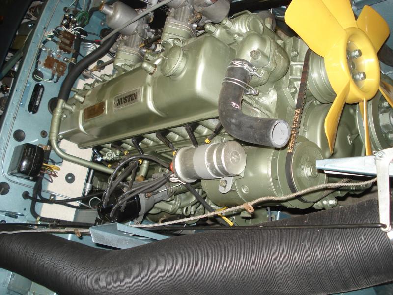

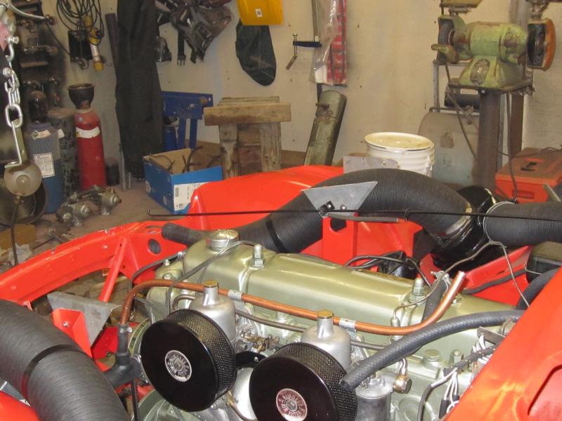

Thats very close to ours. One other note on the breather tube. The road draft portion must be from the other make of car too. The Healey would have just connected to the valve cover and the lifter cover. Here is pics from ours.

A couple of points: you said the motor mounts may need re-positioning. Healey motor mounts are handed. There is an RH stamped on one and a LH on the other. If they are reversed things will not line up properly. Secondly, if this engine is truly a rebuild and has never been driven, you should certainly break in the cam and lifters first.
The two cars are very close to each other - not sure whether Healeys are brothers or sisters. Thanks for the info on the breather tube. I assumed, wrongly, that the early Longbridge cars dumped the breather downwards. I can rob the correct parts from a spare engine of a later vintage, and may do when I have another reason to remove the valve cover.
