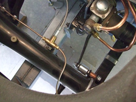

Akilter, This is just my opinion but I don't believe you need any higher pressure fuel pump than what was original to the car. I've been messing with carburators of all kinds for over 40 years and with higher pressure you run the risk of flooding problems with the carbs. SU included. Here's a picture of one of the two pumps on my BJ7.
Are those copper tubes to and from your pump? Copper tends to work-harden and crack with vibration, not that we have that on a Healey. If they aren't copper, they look nice.
John, Those pipes are original replacement pipes for the Healey, I just straightened and reshaped them to my application. I bought them from Healey Surgeons in D.C. i'm pretty sure they are a copper/nickel alloy which I'm told is commonly used in some very expensive modern cars.
