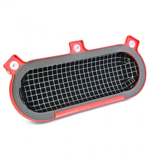

I was wondering which air filters to install on my TRICARB
I saw the KNs, the pipers
but there are also RAMflows with two installation heights ...
this would allow better access to the richness settings
what do you think of these air filters for road use ?
there is even another one with no hole !!! to adjust the height ...
are they usefull ???

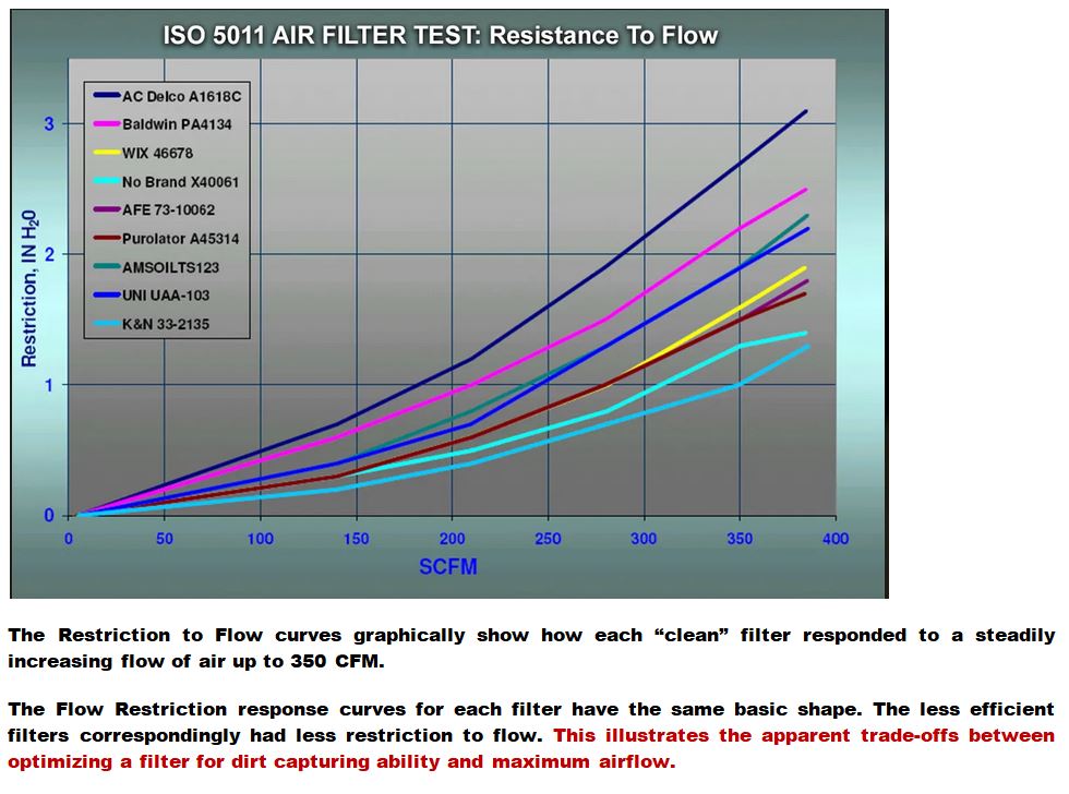

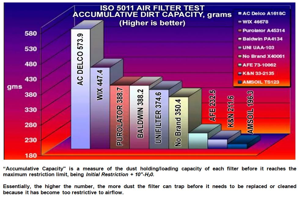

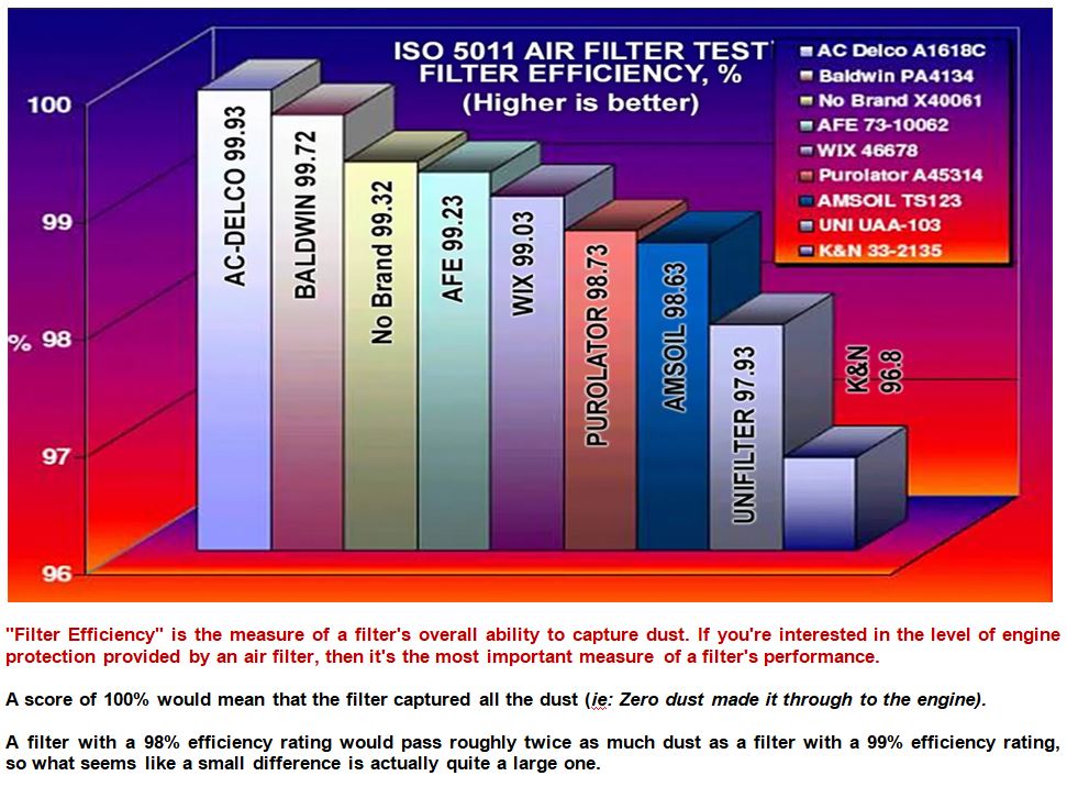

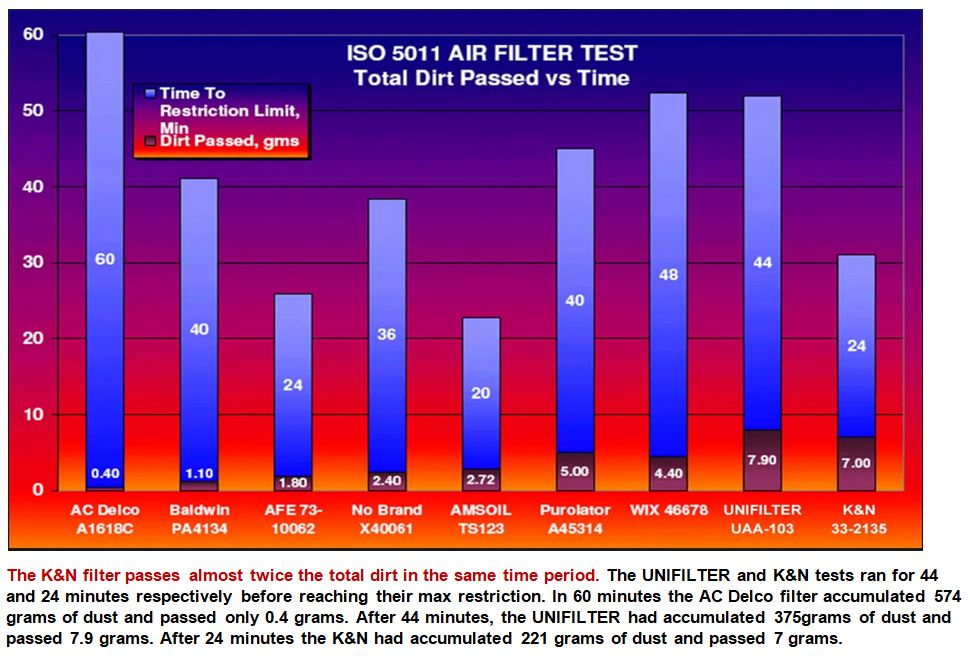

A lot of good filter testing was done by the motorcycle community from 2005 to 2010 comparing filter flow rates and effectiveness. Either oiled mesh or oiled foam can be a filtering improvement over the original Coopers oiled wire mesh. And, the foam filters typically have a better air entry/intake flow pattern (like the Coopers filters) compared with most short, side entry mesh filters.
Quality oiled foam filters are more effective (filter better) and hold more dirt than quality oiled mesh filters; although, they have slightly less flow rate for the same surface area initially when they are perfectly clean (why oiled foam filters better); and they are used extensively in applications where dust and small dirt particles are a problem such as off-road motorcycle and automotive racing. K&N recommends foam "socks" over their mesh filters in dusty applications that require improved small particle filtering.
Of interest to us in real life applications, foam filters hold more dirt particles than mesh filters and will actually flow better than mesh filters as dirt is trapped between cleanings.

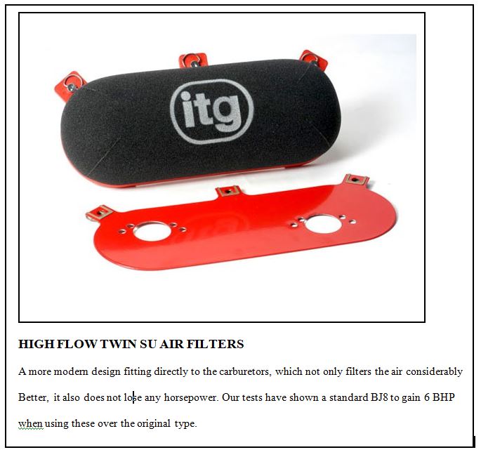

I would personally use a foam filter with a wire support grid inside of the foam filter if possible similar to ITG, and add a stub ram like APTFast.com sells. Please see the images below that compare paper, mesh and foam filters.

EDIT1: The UNIFILTER is a foam filter and it should be compared with the paper filters and the K&N mesh filter shown in the charts.
EDIT2: People who use the Ramflo foam filter sometimes make a wire mesh frame inside of the foam for improved support.
